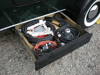

Postby bobhenry » Fri Jan 14, 2011 9:50 am
Erv has storage drawers on his trailer and I loved the idea as soon as I saw them. Maybe he will chime in and give us his insight on how he did his.
I have this shot of his ......

Postby Mike-n-Britney » Fri Jan 14, 2011 10:01 am

bobhenry wrote:Erv has storage drawers on his trailer and I loved the idea as soon as I saw them. Maybe he will chime in and give us his insight on how he did his.
Who's is this ^ ? It kinda looks like a Silver Shadow... ?

Postby ERV » Fri Jan 14, 2011 3:39 pm
Those are my drawers :lol: that Bob showed you. I just made a box out of treated 1/2" and put the drawer in it. I did seal the edges of the box and painted them. I have one on each side. Just made the front of the drawer the front of the box. So when it is closed it seals the box and drawer. I just have two bolts on each side keeping them closed, with wing nuts. So far no water or dust in them. I have a few other pics in my album if ya want to see more. Just put them together in the drive one night out of scrap wood. The only thing I would do different is made them deeper. I kept them a little higher than my spare tire, but I could have drop them another 3-4 inches without worrying about them hitting anything. I have been watching them as we go to different places and I always have plenty of room.
