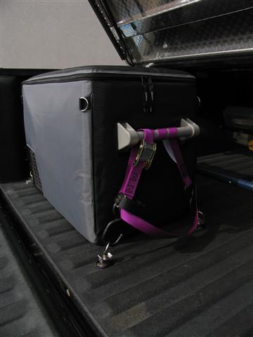

Here's the refrigerooler tied down to the truck bed.
I used a cam buckle strap wrapped around the handle and it's secured directly to the bed.

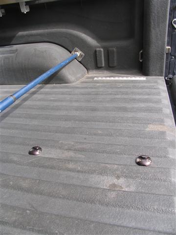

Here's one of the tie down points. As much as I hate to drill holes in my vehicles, I went ahead and did it. I used an anchor plate with a single ring tie down stud in the middle of the bed.

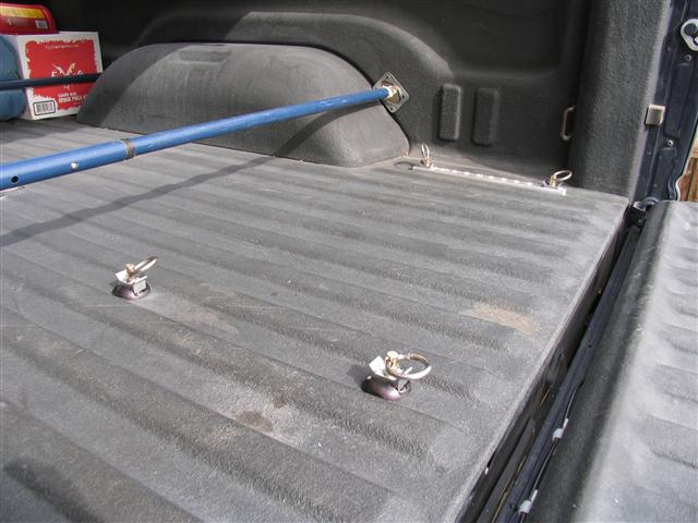

I used a track system for the outside connection points. It gives more choices for spots to tie down to and uses the same type of tie down stud.

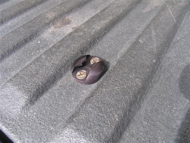

Take the studs off and the anchor plate is just a smidge higher than the ridges in the bed. I'm thinking it won't get in the way much at all. The track is lower than the ridge so it definitely won't get in the way.
I had to grind down the anchor plate about 1/8" a side to get it to fit in the ridge. I colored in the end with a felt tip marker.
