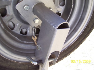

Postby bobhenry » Mon Mar 14, 2011 8:06 am
Enigmak has hers done .......Image
And now we know where she hides her spare key :lol: :lol: :lol:

Postby enigmak » Wed Mar 16, 2011 7:09 pm
Sorry to disappoint you, but "he" is a She. :lips:
We have His and Hers teardrops and the yellow one is mine. His matches his 41 ford pickup.
I really love my tire/table. It works great! And as for the key, you have to know how to get to it before you can use it. :roll:

Postby pete42 » Wed Mar 23, 2011 8:01 am
Dana I just looked at your album and the table.
I was curious how you kept the table from swinging out when going down the road.
It looks like it fits into a trailer door lock one that keeps the door open when using a screen door.
or is it something else? either way nice clean design.

Postby enigmak » Thu Mar 24, 2011 9:47 pm
Pete, it swings into a hole in the frame and locks in place.
