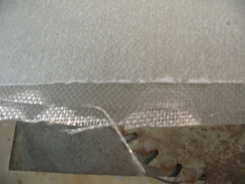

Last night I bonded two layers of 10oz fiberglass cloth to blue (Dow) styrofoam with epoxy resin.
This morning it took very little effort to peal the cloth off of the styro. (low shear strength...there was a thin layer of blue styro still stuck to the cloth)
All that being said, I think you can use 1/4" plywood and get a good build, but I don't think the weight savings over a traditional 3/4" framing build will make it worth it.

Postby RockyMountainTeardrops » Fri Apr 01, 2011 8:26 am
Ageless wrote:Lee; did you bond up under pressure? Several test pieces I made up using white foam became very strong. These were laid up using waxed aluminum plates clamped together. Possibly that is what caused you bond failure?
Yep, stacked approx 70lbs on a 5" x 20" test strip. (not a lot compared to vacumm, but plenty to ensure a good bond)
It wasn't a bonding failure...
When I pulled the skin off, there was a nice thin layer of blue styro stuck to it.
That's what leads me to say it was a core shear failure. :thumbdown:
I think it's plenty strong enough for a TD,....but I don't feel like the core (styro) is tough enough with a light, thin layer of fiberglass to give a good, long lasting TD. (if I bump a tree, I want a scratch. not a hole)
