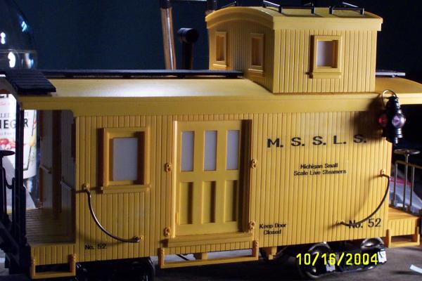

I've been developing a camper concept on the computer and am not yet happy enough with the idea to post pictures. But I thought I would mention the idea in case anybody else wants to think about it.
I would like to see a small standie trailer that looks like a miniature train caboose. The raised "cupola" portion of the roof would be at the back of the trailer. Together with a drop floor, this cupola section would be a good place for the galley and the only place where a person could stand up. The rest of the trailer would have a lower roof and this would be the dining area that folds down into a bed. I would actually like the bed to be two narrow beds with a footwell between them and have storage drawers under the bench/beds that pull out into the footwell.
The exterior should have lots of custom welded railings and miniature steps to complete the caboose look. There should be train lanterns hanging on the sides and the name of a railroad painted on the sides. There should be ladders and a walkway down the center of the roof. This could be for show or to access some kind of outside storage.
I have not been able to get the proportions the way I want them yet. . . but maybe somebody else might have some ideas. I think this could be a very sweet little trailer idea.
Here is a photo of a sweet caboose to get you thinking:

Postby Deryk the Pirate » Tue Jun 28, 2011 11:08 pm
Duane I saw something slightly similar for sale on ebay a while back. Wasnt standing headroom but the center roof area was raised up. Being a vardo man, I like the look of it.
deryk

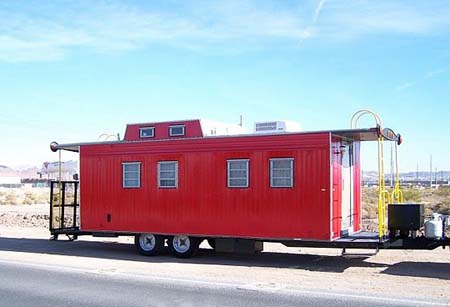

Postby emiller » Wed Jun 29, 2011 12:51 pm
Duane when I headed up to the first IRG we saw a red one in Santa Cruz, CA. Pretty neat too bad they don't use a caboose anymore.

One of my concerns our would be wind resistance and you could make a cupelo either a pop-up design that used the roof section for sealing to the body of the trailer and some mechanism to raise it or use a fold up design of some sort. Composers were usually built very simply and very cheaply because they were a nonrevenue item that was tacked onto the end of the train i.e. they did not make any money transporting freight. There were however some designs that involved a freight hauling capacity and that is what is shown in the picture of the caboose that you have their.
Postby bobhenry » Fri Sep 30, 2011 7:31 am
This one is not a travel trailer this will be a towable mobile home. Staying under 8' wide and 13'6" overall height is my prime concerns.
I am lucky in that our little hamlet has a railroad museum and on display are a flat top side view and a rear cupola caboose. I stopped in last night and took some measurements. My preliminary ideas are spot on with what I found when measuring the rear cupola model. I was unable to get inside as they are locked. The museum is only open on some weekends but looking thru the door glass I was able to see most of the interior.
The wreck measures 7'6" wide by 20' long It appears with a little creative welding I can add the rear observation platform making 23' overall. The front is a bit more of a challenge as the tongue is quite short The observation platform would need to encroach 12 to 18 inches into the body and I am not sure I want to give up the interior space. Perhaps clipping the corners at a 45 and still trying to maintain the look would work.
The existing rear bath in the wreck is really nice if you can hold the hope that avacado green will make a comeback :) The tub, sink ,and toilet are a one piece fiberglass afair and will remain in place . The, to be added, rear platform will have a faux door only. This platform would make a great place for a large storage box.
Entry into the trailer will primarily be by the side baggage door. A porch, deck. or ramp will be in order to make entry easier. Looks like final dims will be 8x8 x 25-26 feet coupler to rear the cupola will add another 2 to 2 1/2 feet overall height should come in at 12' to 12' 6" ground to highest point.
We are both excited just wish we were rich :lol:
P.S. Norm: The semaphore trailer links were fantastic it is exactly the look I am hoping to acheive. Thanks for the info.

Postby CARS » Fri Sep 30, 2011 2:14 pm
bobhenry wrote:What do ya think so far.......
OK just kidding this is a great shot of one of the semaphore caboose trailers I was able to find on the net :thumbsup:
That is AWESOME!!!
I do have to wonder what it is like to tow??? There has to be some resistance there.
