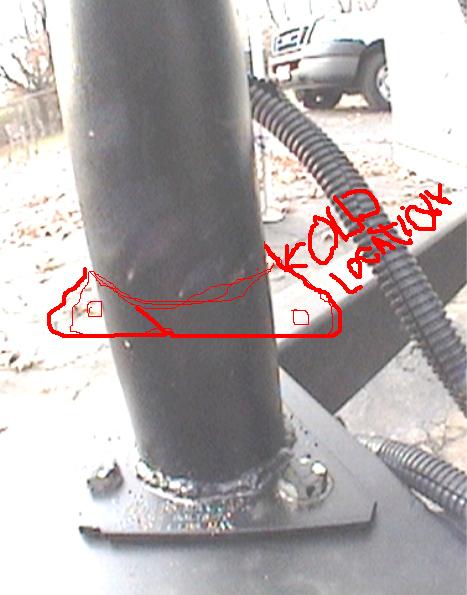

When my jack was fully retracted (originally) it would not lower the trailer enough. The A-Bracket was welded to high on the jack tube. I unbolted the jack and cut off the A-bracket with a 4.5 inch angle grinder with a cut off wheel. Then I used a grinding wheel to smooth out the remaining steel. I went to my local trailer supplier and bought a new A-bracket for like $3 if I remember correctly. I set bolted the new bracket to the tongue and used 3d hand welding magnets to hold the jack tube in place with only about an inch sticking out the bottom of the tongue. I spot welded it and then removed and finished the weld. Now it is almost flush when the wheel is removed.
