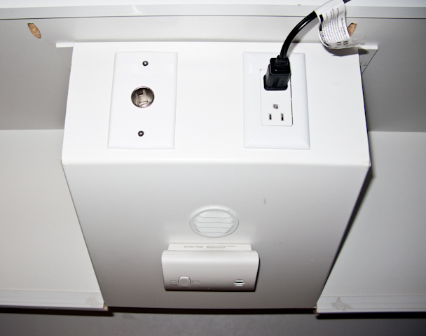

You could also do what my wife and I did. We bought a CO detector/alarm from Home Depot and installed it in our Little Guy 6 Wide, just to be on the safe side. We installed it on the converter housing which is in the middle of our cabin under the cabinets. It was only about a $17.00 investment.
Be safe and enjoy your camping experience!
