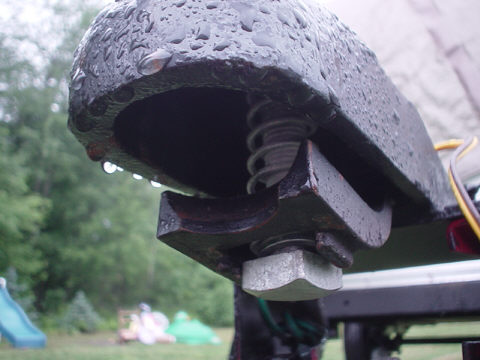

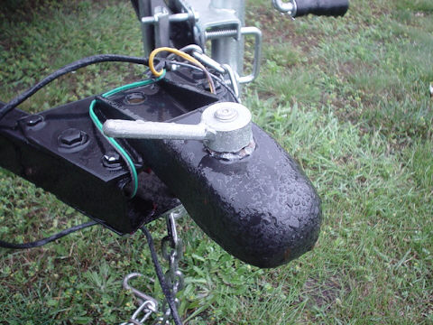

Here's a pic:
http://www.tnttt.com/gallery/image.php?image_id=238
and underneath:
http://www.tnttt.com/gallery/image.php?image_id=239
We have NEVER seen a hitch like this before. When we tighten down the doo-hicky on top, Bob can barely get it undone, let alone myself! And we believe you have to tighten it down to tighten it to the ball.

Postby Jiminsav » Sun Jul 04, 2004 6:55 pm
Hey Bev,
That hitch you have is a all in one hitch..the purpose of it is so that you don't have to change ball sizes all the time..it's a very good hitch, but it does require some man handleing..when we use the one at work, we tighten it snug, and usually have to hammer it off when we are done, sooooo, your not having problems with it, your just not used to beating the heck out of your equipment. :lol:

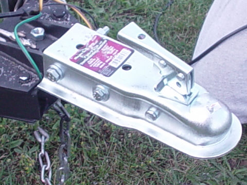

Postby beverlyt » Mon Jul 05, 2004 7:38 pm
We worked on our hitch today.
Ground the original hitch down just enough to set the new hitch on top of it. We then drilled holes, inserted large bolts with lock-tite nuts and have a regular hitch again!
This made the hitch about 5 1/2 inches longer than the old one. Should work fine and it's something I can handle!
