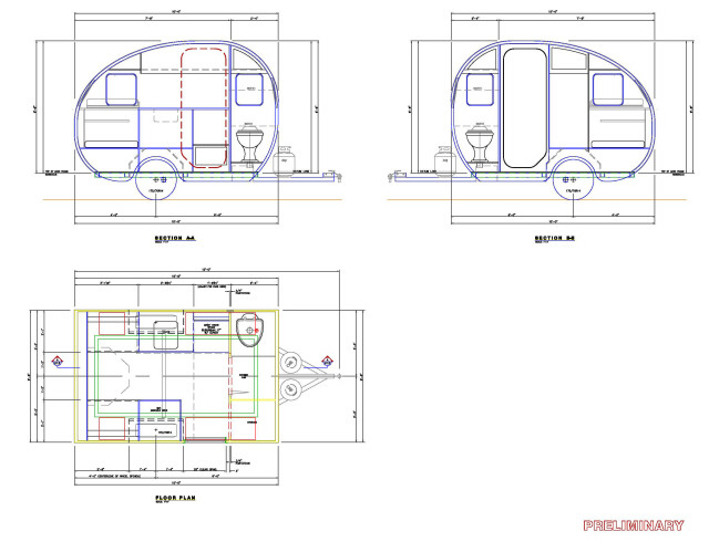

Postby gww25 » Sat Jul 30, 2011 6:26 pm
When I first started looking at designs the two that looked like I could use them were the old 1940 'Terra-Cruiser' and the 'Widget'. The Cruiser was to large and the Widget was a little to small. In the end I just kind of melded the two design together and came up with this preliminary concept.

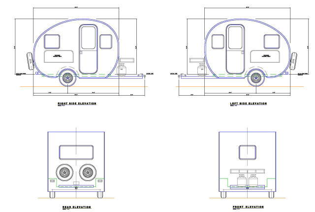

Postby gww25 » Sun Jul 31, 2011 4:08 pm
I'm still working on the profile, trying to cut down on surface areas as much as possible to save some weight without cutting into people-space. This is the lastest version so far.

Postby jandmz » Sun Jul 31, 2011 7:29 pm
If you put one of your beds along an outside wall, you could open up the outside wall underneath the bed and put a slide out galley in the space under the bed. That way that bit of floor space does double duty.

Postby gww25 » Sun Jul 31, 2011 10:12 pm
That's a great idea. One of the interior options I've been working on is bunk beds on the sidewall.
