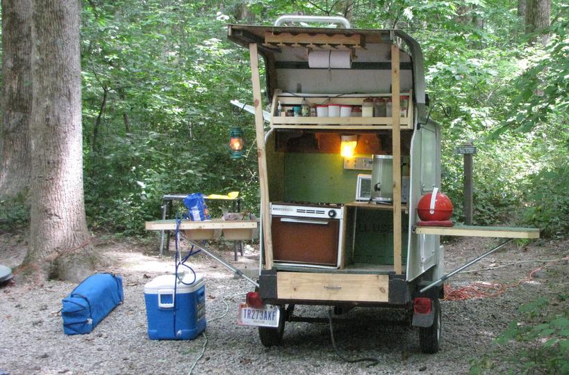

Postby bobhenry » Thu Aug 18, 2011 11:55 am
I gotta second the exterior 120 v outlet. Here is a link on a rather inexpensive table attachment method for removable side tables....
http://www.tnttt.com/viewtopic.php?t=43504&highlight=side+tables+again
We tested out the bat wing tables on the chuckwagon at the Crossroads of america gathering, and they worked great. Not a thing I would do differently. Having an outlet directly above the table worked out great for lights as well as small appliances you may want to use.
(The blender for the margaritas) :thinking:
I am going to install identical rails on the 4x7 sleeper trailer and I will be able to "borrow" the chuck wagon tables to use with the other trailer as needed.
I have just had an original thought while thinking about the boat cleat. By mounting a heavy duty pull handle on or just under each side it would make a great anchor point to hook a ratchet strap for the ez up to keep it on the ground in windy situations.

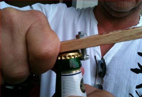

I have already added a redneck bottle opener to the chuckwagon.
A short elevator bolt pulled thru the side and a 1/4 " carriage bolt just above it. I spaced the carriage bolt out the thickness of the square shoulder bolt by using an undersized washer so the carriage bolt extends out about 3/16 - 1/4 ". Just slide the bottle cap under the carriage bolt lip and pry down on the flat head of the elevator bolt and pssssst its open.
I like it because it drives folks crazy trying to figure out what the hell it is !
I know, I know , I gotta get a picture :oops:
Here was my inspiration........Image

Postby bobhenry » Thu Aug 18, 2011 12:40 pm
Guess I had better get you to level my crooked stove .....
What can I say I was up against a deadline !
Here is a shot of the tables !
