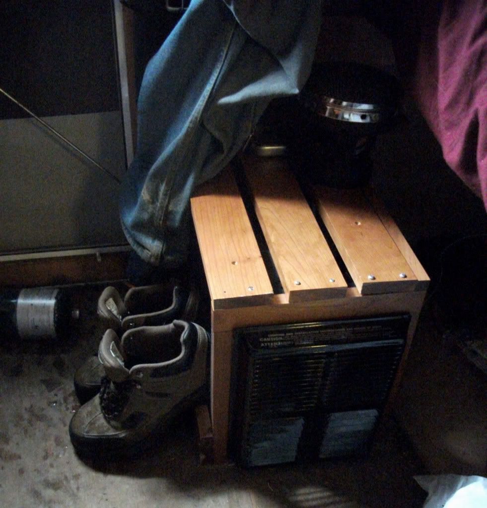

Postby southpennrailroad » Sat Oct 29, 2011 10:27 am
I love my toasty furnace. Feels so good. :twisted: :lol: :) :D ;)
used hickory from left over scraps of wood from work. Nice bench as well.

Postby droid_ca » Sat Oct 29, 2011 11:01 am
can you tell us more about your furnace please :twisted: :twisted: :twisted:

Postby southpennrailroad » Sat Oct 29, 2011 11:05 am
droid_ca wrote:can you tell us more about your furnace please :twisted: :twisted: :twisted:
Atwood 18,000 BTU. Puts out 13,000 BTU's. One year old used it all winter last year after getting rid of blue flame heater. Paid $430.00 from Atwood furnace factory in Washington state.
phone 1-360-693-9167.
This is the number I called when I had a problem. They were great help.

Postby Engineer Guy » Sun Oct 30, 2011 10:49 am
'Southpenn' -> Nice Furnace implementation, there.
I've got a couple of Atwood Furnaces in 2 Trailers. The 12,000 BTU one, identical to the Furnace footprint shown above, pleasantly surprised me with how quiet it is. The Plate on it shows a 1.8 Amp current draw @ ~+12 VDC; another pleasant surprise for this Boondocker. It very nicely heats up my '89 TT's 14' x 8' x 6.5' Cabin just fine on 32 F degree mornings. It has the usual ~1.5" of Fiberglass within 2" x 2" Wood Frame construction. Of course, it exhausts combustion byproducts and moisture to outside Air.
The 18,000 BTU Atwood in my 31' 1983 Avion pulls over 6 Amps, and is obnoxiously noisy. It's not an issue of Bearings or some other fault. It's simply a matter of moving more Air through the House-style Ductwork that causes the higher dB level.
The usual 1,500 Watt Electric Heaters [~13 Amps draw @ 115 VAC] output ~5,200 BTU. My Calculator tells me that this lil +12 VDC Heater draws just shy of 25 Amps @ +12 VDC to produce ~300 Watts, or 1,040 BTUs. This assumes that appropriate Wiring and Connectors to minimize Voltage drop have been installed.
+12 VDC Heater Thread
The values herein are rounded numbers. I'm not de-rating calculations for inevitable inefficiencies. Keeping it simple lets folks generally compare Apples-to-Apples.
I've worked on the Atwoods and find them easy to understand and maintain. I retrofitted a Dinosaur Fan Board to my older Atwood. That PCB tries to light the Pilot 3 times and then times out until reset manually. This prevents killing the House Batteries if Propane runs out. There's also a great body of 'Net info on the Atwoods to enable Troubleshooting, and readily-available Parts.
Atwood Furnaces
