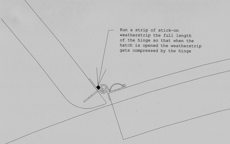

Postby RPH » Sun Nov 06, 2011 7:09 pm
I haven’t tried this yet but it is simple and doesn’t require any modification to the trailer or hinge. Simply attach a strip of adhesive-backed vinyl weather-strip to the lower section of the hinge where it will come in contact with the upper part of the hinge when the hatch is opened This should completely seal the hinge from rain water running down both the hatch and the roof.
