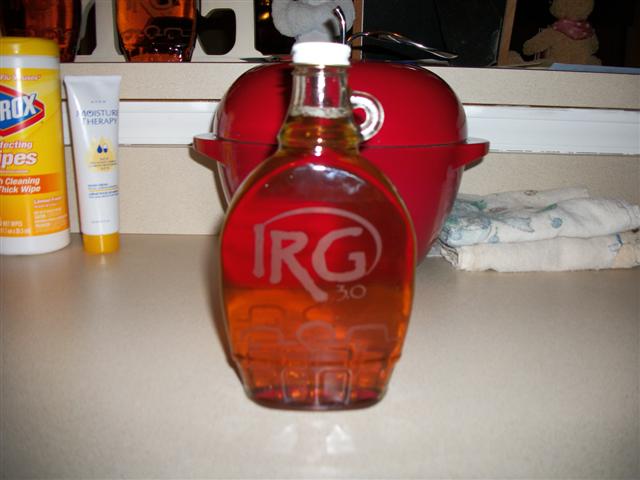

Postby Mark72 » Sun Nov 20, 2011 2:18 pm
That is the stuff I used to make these a couple of years ago.
Mark
