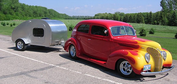

I wanted mine to match the alum on the tear. I just had a automotive paint shop match a silver to a sample of the alum and painted the steel fenders. The match was good and I can repaint if and when its needed. So far so good.
