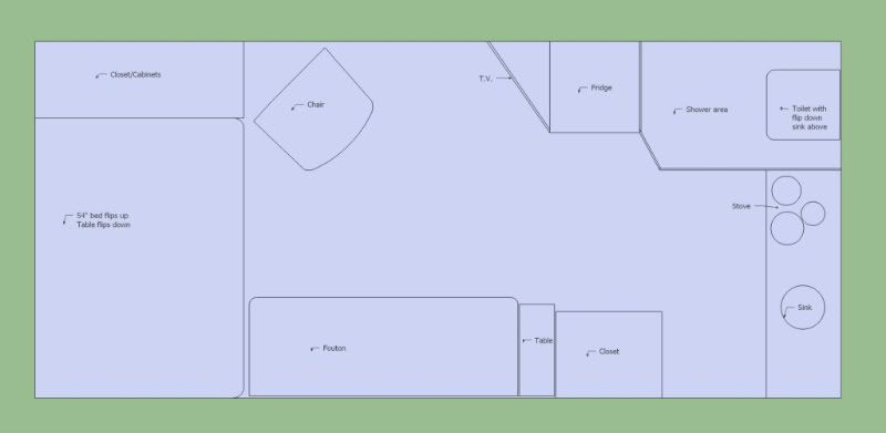

Inside would be 95.5" wide by 18' long.
Designed to be as small as possible but have a usable wash-room ( I hate small wash-rooms that I can not fit in, have spent lots of time thinking about and designing different wash-rooms) Bed can stay down and uses a regular comfortable mattress, Flip up if want table inside for eating.

Postby Goatdog » Wed Feb 15, 2012 9:20 pm
I like it!
The big open space in the middle is nice and the TV can be viewed from the bed, futon, and chair.

Postby loaderman » Thu Feb 16, 2012 9:25 am
Didn't write it on the plan but microwave will probably be above fridge.
I am designing this as a trailer I may live in. May get a job where I will be away from home.
Many guys live in campers year round even in winter. Just wanting something warmer, will have R10 styrofoam.
Also as I said most RV washrooms are way to small.
Basically a hotel room on wheels.

Postby jandmz » Thu Feb 16, 2012 5:48 pm
I would switch the closet and the fridge locations. I think it would be a more convenient "work triangle" in the galley area by putting the fridge closer to the "work surface" (counter space) next to the sink.
When you load weight into the rear of a trailer, you tend to reduce the tongue weight. Your design may limit how much weight you can load into the under bed storage without causing a sway problem.
Other than that, it looks like a design I could camp in...

Postby loaderman » Thu Feb 16, 2012 7:26 pm
I thought about the fridge closer to the kitchen.
The reason I went this way was to add a little length to the bathroom, and also allow a bigger closet and the closet is beside the door for shoes.
