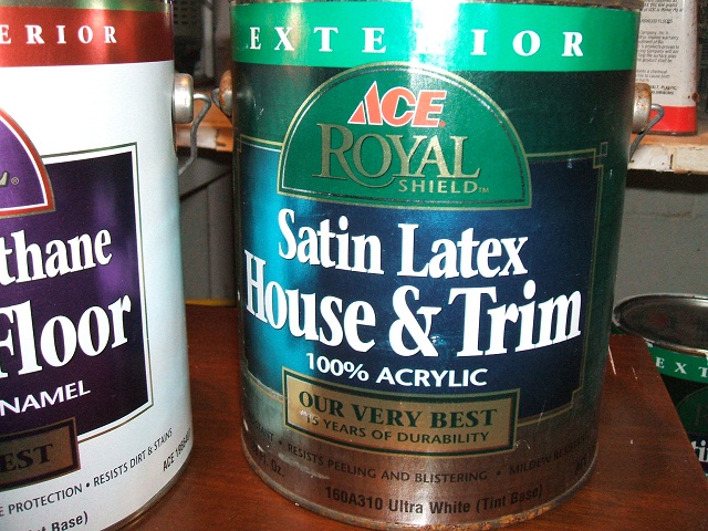

I also have these two that also have never been opened.
It was extra trim paint for my old house that was never opened. It's a medium gray.
It's from around 2003 or 2004.
I've got to start dating this stuff when I buy it.

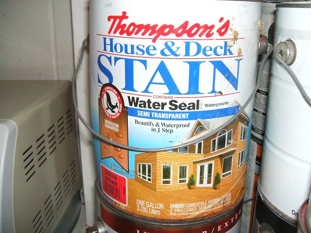

This is brown. I have no idea how old it is. maybe 2000

The paints should still be good. However, there are a few ways to tell if an enamel based paint has gone to seed. First open the can and see if has skinned over. If it has never been opened it shouldn't be skinned over. If it has skinned over it can still be used, however carefully remove all the skin before mixing otherwise lumps of skin will contaminate your finish with "seeds". Skinning over is caused by the oxidation of the paint with exposed air that was left in the can when it was closed. The other way to tell if the paint is bad is to mix it. It should be fairly easy to mix up the sediment from the bottom of the can. If the sediment is very hard and pretty much unmissable then it is no good. Enamel and oil based paints should be disposed of properly by dropping them off at a community household hazardous waste event.
I would check the Thompsons Water Seal to see if it is alkyd based before using. Normally, the "water sealing" agent used by Thompsons is nothing but parrafin wax. If you go to paint or varnish over this later, you may have adhesion problems. Alkyd based water sealers are better to use.
Also, just an FYI on latex paints. If they smell bad or are moldy don't use them. These are definately no good to use.
