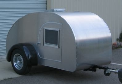

Postby cuyeda » Fri Mar 16, 2012 1:06 pm
Not mine, but have always liked this one.
