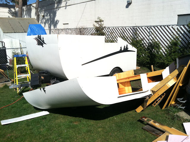

This weekend I am going to start thinking about a new weekender design.
The original weekender plan is here: http://mikenchell.com/weekender/
If you recall, the plan was to have something camp-able in just a couple weekends. But the downside to the original design was having to drive screws into the endgrain of the plywood.
So I think it's time to revisit the weekender. What can we do to improve the original weekender, and still build it in 2 weekends?

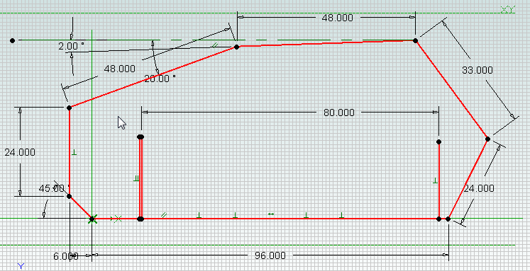

I think we should allow space for heating and a/c, if a person wants to add that later.
I think we should get rid of that flat spot on the front. Replace it with a point.
The original was designed to be built on a 5x8 trailer. Sure would be nice if we could do something on a 4x8 trailer and hang over the edges...
Any ideas from you guys?
