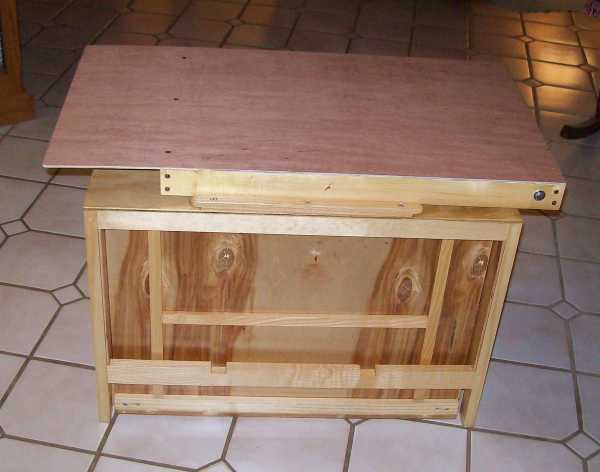

Postby Festus » Sat Mar 24, 2012 8:13 am
Dan, I'm going to hijack my own thread here.
I liked the Blue Sky Kitchen chuckbox plans (they have several models, I think the one I modeled this after was called the "Grubby") and was going to buy a set of plans from them and couldn't get the website to work right when I tried to order, so I got fed up and just decided to build my own version.
My side table is a seperate unit from the actual chuck box and is different from the BSK models. I didn't have it varnished in these photos, but it is now.
The chuckbox is several pieces that all go together when closed. When closed up, the bottom section is actually a table that sits over the top section. When open, the table is removed from the top section, and the top section is set on the table.
There are two panels that cover the open sides of the top section when closed up for traveling. These panels are slid out and one panel makes the side table which is slid under the top section and is held by the weight of the top section and also a couple of "ears" fastend to the bottom table. The ears also keep the top section from sliding forward or backward off the bottom table. The side table is good only for relatively light things, don't try to set a dutch oven on it : ). The other panel makes the shelf on the bottom table which can be moved to either side and sits in notches in the brace of the table to keep it from sliding around.
And last is the big side table. The legs fold up on it, but it is entirely seperate from the actual chuck box. It slides under the top section just like the panel does for the small side table and is held by the top and ears also. I added a couple of short dowels to help locate the table and keep it from sliding and also to take the weight of the 1/4" plywood top. The dowels are glued into the side table and slide into holes drilled into the bottom table.
I built the whole thing from scrap I had. It is made of 1/4 plywood and 1/4 laun plywood, pine and ash. The plywood was all left over from my teardrop build. I ended up buying a quart of polyurethane and some cup hooks. So I've got about $12 in it. It took a weekend to build it, plus a few days to varnish it.
It's pretty hard to explain how it all works, but It can be set up in less than 2 minutes. It has a drawer, but you could add another if you wanted. On one side of the top there is cup hooks and you hang your tongs, spatula, etc. On the other side is a spice rack. It's a really slick idea, but I can't take any credit for it. The BSK website has some great videos of how they work, and I would suggest buying their plans if you're interested. I think you can get them individually for $10 each. No, I am not affiliated with them in any way, but actually I could have probably built mine in less time if I had an actual set of plans. (But I probably wouldn't have had as much fun!)
Hope this helps!
