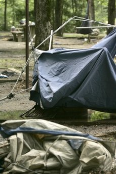

We have three simple tarps that attach to Kedar/awning rail Two Kelty Car Tarps and One Made by PAHA QUE
80545
80543
These are very light weight, take up little room and are very quick to erect.

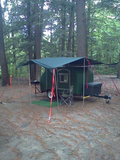

Postby kirkman » Mon Mar 26, 2012 12:37 pm
Here's mine. I had Marty make it for me.
http://trailerawning.blogspot.com/
