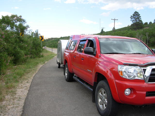

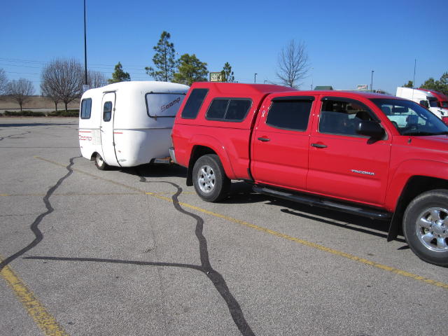

Frontal area of the towed trailer definitely makes a difference in fuel efficiency but IME not as much as wind. My TD 'tucks' in the wind shadow of my TV & under normal driving conditions my mileage driving solo drops from around 20-21 to 17-19mpg when towing the TD. I have a 13' Scamp molded fiberglass camp trailer with pretty near the same frontal area as the TD, just a little more curved. It & the TD weigh near the same. I've towed it several hundred miles (vs several thousand for the TD) but up to now fuel mileage has been identical with both trailers. Have not had any severe winds towing with my current TV (2008 Toyota Tacoma V-6) but had near the same fuel efficiency with the previous TV ('95 Nissan Hardbody KingCab 4X4 P/U, 4cyl w/5sp trans). Towing across NW Kansas (pretty flat country) with the Nissan & TD in 2007, we experienced 30-45mph quartering headwind that dropped my fuel mileage to less than 13mpg & I wasn't able to maintain the speed limit (55mph) in 5th gear. Some of that was probably because of the smaller, 4cyl engine but, the wind definitely made a huge difference.
Tacoma with TD
Tacoma with Scamp
As you c an see the Nissan didn't provide quite as much 'wind shadow' for the TD
Harvey -
