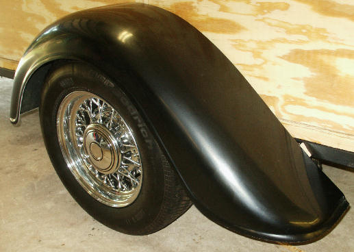

Postby Steve_Cox » Sun Sep 18, 2005 12:00 pm
Nick Taylor wrote:The bolt pattern size is 5 on 5.5". You might want to use later wheels though. I may use 1935 Ford wire wheels on my trailer. They use a 16" tire which you can get in a reasonable width. Model A tires are very skinny and tall.
This is the style of wheel I'm talking about.
Nick.
Nice wheels. I was thinking of having these powdercoated but decided to leave them chrome. Mclean 50 spoke, 15 X 5, 5 on 5.5.
Steve

Postby Steve_Cox » Sun Sep 18, 2005 12:03 pm
Oops, left out the picture.
Steve in St Augustine

Postby Nick Taylor » Sun Sep 18, 2005 8:14 pm
Steve_Cox wrote:Oops, left out the picture.
Those look like the reproduction Kelsey Hayes wheels from Wheel Vintiques. Are they?
Nick.
Nick Taylor
Posts: 432
Joined: Tue Jun 08, 2004 8:18 pm
Location: San Diego, CA
Postby Steve_Cox » Sun Sep 18, 2005 8:38 pm
Nick Taylor wrote:Those look like the reproduction Kelsey Hayes wheels from Wheel Vintiques. Are they?
Nick.
Nick,
Nope, Mclean wheels, 50 spoke, got em on ebay. I couldn't find them on the Mclean website though.
