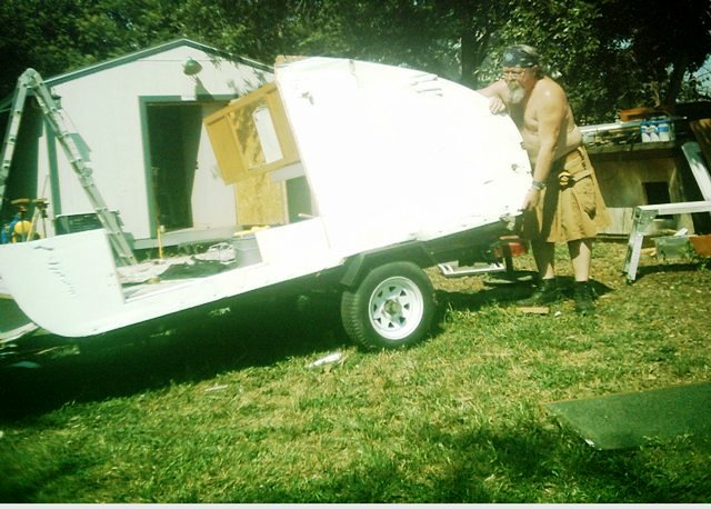

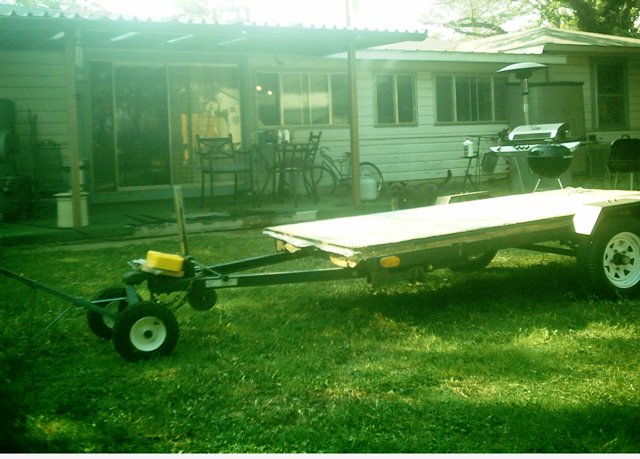

I've been away for a while but am considering my next camper as today I finally got around to wrecking out the Escape Pod. It was a bit of a sad day but actually the bare HF trailer is easier to look at than the delaminated mess that it had become. I had some pictures in mind to post but for some reason I am unable to load them in my album in order to post them here. Guess I have been away fro too long and did not keep up on the forum changes.
I'm not sure what I will do with the HF frame at this time but I am considering building a TTT this time around instead of an actual TD. Not sure whether the frame will work out for the new (non-existent) design or not.

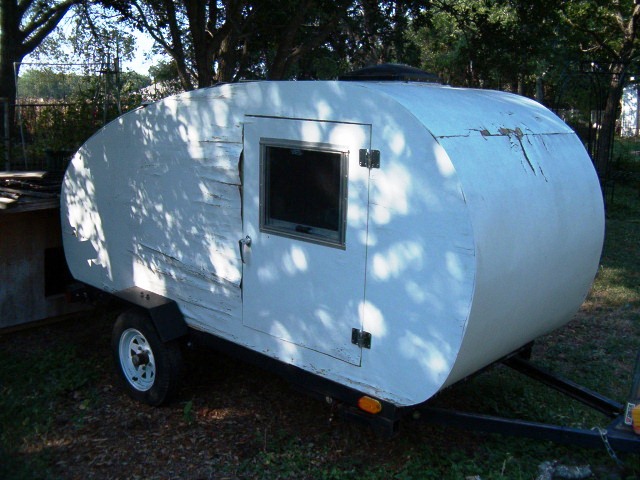

The Escape Pod

Ouch! I know the feeling of wood that has delaminated.
I'm using http://menards.com/main/building-materi ... c-5698.htm which is an exterior plywood. I shouldn't have delamination problems this time.

WHOA !!! That’s TRAGIC!!! :frightened: What happened ... ? Looks like it all started around the edges ... :o
Re: The Escape Pod is no more
Postby Larwyn » Wed Jun 27, 2012 8:34 am
The delamination started very soon after the paint was applied. I used Kilz's "best" oil based primer and a "premium quality" house paint. The plywood seemed fine before painting so I suspect that the primer that I used contributed to the problem. Much of the delamination started mid panel and worked it's way to the edges. I had intended to skin the trailer with aluminum but after the health problems and the move I cheaped out and opted for paint, had I completed the trailer as intended it would probably still be fine.
I have not really decided on what to build next but am leaning toward stand up head room this time around. If the HF trailer does not suit what I decide to build I might just build my own trailer this time. Or I might decide on a slide in camper for my truck that could also be used with the old HF frame.
The temp here in Kerrville was reported to have been 109 f during the tear down yesterday so it is not likely that any serious building will commence before the weather begins to cool again. A couple of weeks ago I put up a new carport tent behind my woodshop in anticipation of the upcoming build. There should be much more room to work in there this time around since all the heavy woodworking tools are in the shop rather than the temporary shelter.
Just about done;
Here's what is left of the Escape Pod;

Sorry for your troubles !!! That de-lamination is the main reason I steered away from using any plywood at all .. :NC

Heartbreaking photos, Larwyn. But...the upside is that now you get to start fresh with new ideas and a chance to build something based on experiences with the old camper. You know now what you liked, what you didn't, what you wish you had done the first time around. And you get to experience the joy of creating something again. And that's half the fun, right?

GPW; Yes I am considering alternatives to using plywood on the exterior of my next build. Cheap Home Depot luan is right out! But I repeat, if I had continued with my plan to skin the trailer in aluminum the plywood would have been protected from the elements and would never have had that primer applied which I suspect dissolved the glue holding the lamination together.

Larwyn wrote:GPW; Yes I am considering alternatives to using plywood on the exterior of my next build. Cheap Home Depot luan is right out! But I repeat, if I had continued with my plan to skin the trailer in aluminum the plywood would have been protected from the elements and would never have had that primer applied which I suspect dissolved the glue holding the lamination together.
What kind of primer was it?
I used that same luan as paneling inside a canned ham that I'm pondering whether to stain or paint in certain spots (like the ceiling).
So, I'm curious if it was the primer that delaminated it or simply weather expsure or a combination of the two (where painting it inside might not be an issue).
