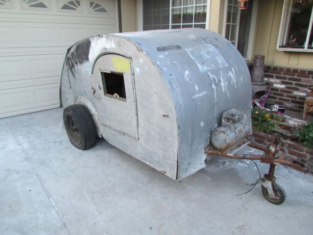

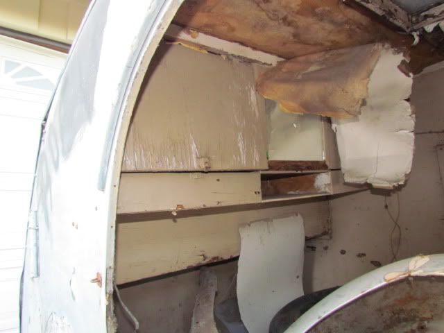

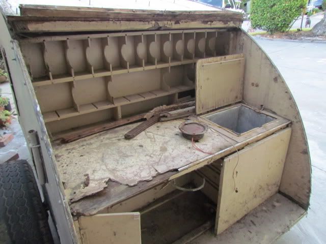

So who can tell me what I have here? Seems to be an original kit trailer but aside from that no idea. tags have been removed so I can't tell the year or model. The little cubbies in the galley are throwning me off too, don't know what to make of them. Thanks advance, really interested in any history on this thing.

It appears to be a Kit, but if it is...it's been highly modified. Kits had a tongue with a drop to it that went under the body, but they would have been originally through the lower notches in the front skin, not where they are located now. My '49 also didn't have any of the doors on the cabinetry. I just had some shelves with a lip on them.
My galley had the icebox in the same position, but also had a sink in it, some didn't have sinks, but a stove that sat on the left side. That's why you got the propane tank on it. The galley cubbies are kind of a question....never seen that set up before, I'd think that's a modification as well. It' has typical Kit windows with the old metal notched sticks to open them.
It also appears to have some of the original studs to attach the canvas accessories. Does it have an offset torsion axle in it and are those the original fenders sitting in the cabin? Who knows...I"m probably completely off base on it. a good shot of the profile would be helpful. Just my .02. Doug

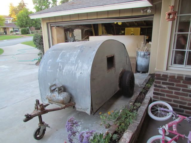

it doesn't show well in the pic but the tongue does have a curve to it. Has the axle mentioned but the fenders aren't the originals, they look like older ford style. I'll get a profile pic tomorrow. Thanks for the info!

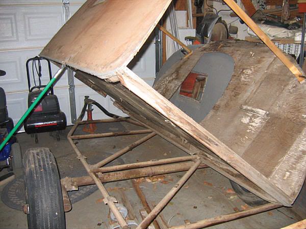

This isn't my frame, but it is the same as this one. Any idea of the make if it isn't kit.

It's hard to say...there were so many different adaptations of things back then. It doesn't have the offset axle like you say you have. I can only go by the ones that I've seen/owned/worked on. Those Kits had a C channel frame, tubular tongue. I'm not an official teardrop guru...can only speak from what I've seen and worked on. Sorry. Doug

I just happen to know a little about that frame. ;) Even though that isn't the orig. axle, you could see where the orig. axles were mounted. I even replaced that axle with a Dexter. The best that Grant and myself could come up with was it was an early '46 and may have been one of the KIT's that went to the RV Show in February of '46. From what I've been able to find out (but no proof) is that the first few KIT frames built by the factory were built with anything (metal) they could get their hands on. :o
Just a little note.
"The first public showing was at Gilmore Stadium in L.A. in February of 1946. They took 12 completed units to the show and booked 500 firm orders at a dealer cost of $500. Some dealers paid in advance. many offered to pay a bonus to get early delivery. The 4'x8' "Kit Kamper" TearDrop Trailer was destined to win the hearts of Americans... and a place in history."

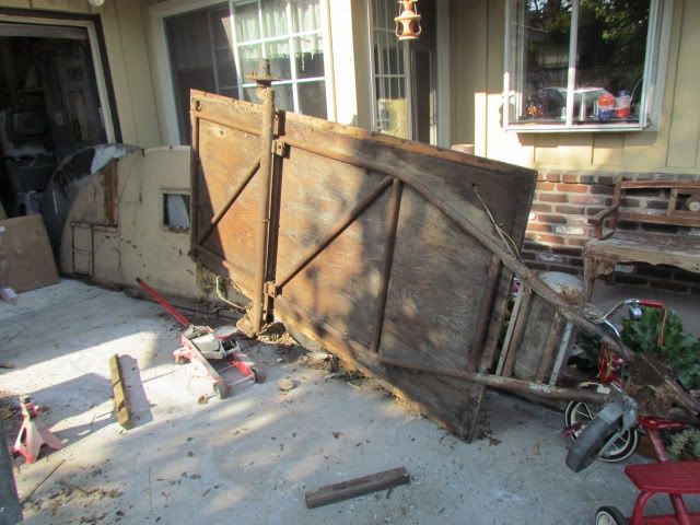

So I was able to tear it down today, here's a pic of the underside. Is this the original axle? How do I know if it is still usable?
