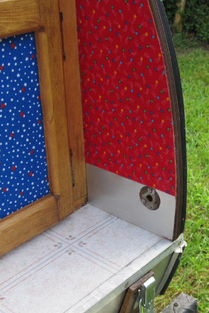

Well that is a problem that most everyone faces once in a while with that type of hatch catch. Even my hatch has come open a couple of times. :o It will happen. What I have done with mine is add a Ball Bungee from the 'T' handle to a hook attached to the frame under the galley. So it's not just Little Guy. It's every teardrop with a floor catch. I changed that method on the KIT I restored. I installed a center 'T' handle that pushes a rod into the side walls (one each side). Don't have the problem with the KIT. :thinking:

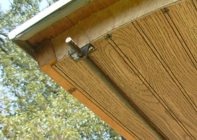

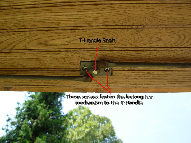

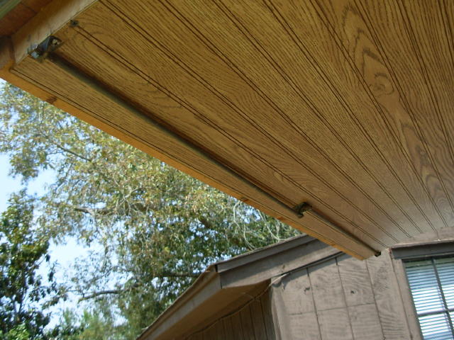

I used a 'T' handle & locking rods like Gage says. Salvaged the mechanism from an old P/U camper shell. Had to shorten the rods by a few inches & devise a receptacle in the sidewalls for the rods but it has served well for 6yrs & 12K+ miles. I did add a couple of 'toggle' latches on the outside for a period of time but one of them was severely mangled in the rear end collision year before last, & since the 'T' handle locking rods had held securely I removed 'em (the toggle latches). For rod receptacles I drilled holes in the sidewalls & 'inset' a large steel washer with 3 countersunk screws for strength. The rods extend about an inch into the receptacles when fastened so the entire trailer wall(s) would have to separate before the hatch could open. In a case like that I'd have lots more problems than just a hatch popping open :roll:
