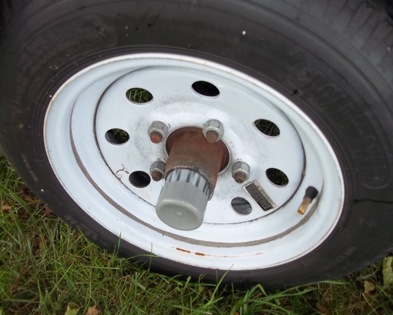

I might recommend some bearing buddies Image
I put some on my TD on my recent trip as I had one hub getting warm while towing, $16 at the local auto parts store, and well worth it. They may be harder to find for the metric hubs on a HF....
lightly loaded the tires are most likely not going to fail, if properly inflated, the bearings are doing the real work.

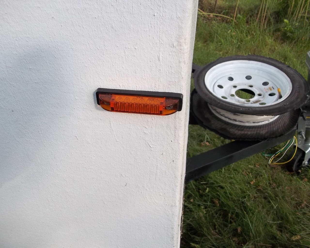

if not properly inflated....Image you can get an "apple core"

On the side of any tire is a DOT (Dept of Transportation) and a number that follows. ex. DOT. 3309 means the tire was made on the 33rd week of 2009. I am hearing that some shops will not mount "new" or used tires that are over 5 years old. Rubber gets old fast and leaving the tires outside in the sun and on the ground accelerates the decay of the rubber. Running the tires at max load rating is not a good idea. The bounce factor and age all leads to the picture shown. Many times when a tire shreds it destroys the wheel well around it. Adding that smaller tires rotate faster adds to the G force in the rubber. All my trailers have 14 or 15 inch tires on them rated way over the limit I expect them to carry. Not being a fan of Made in China, everything that is made there is poor quality compared to made in America. As they say you get what you pay for and sometimes even less. Good luck. Bill
