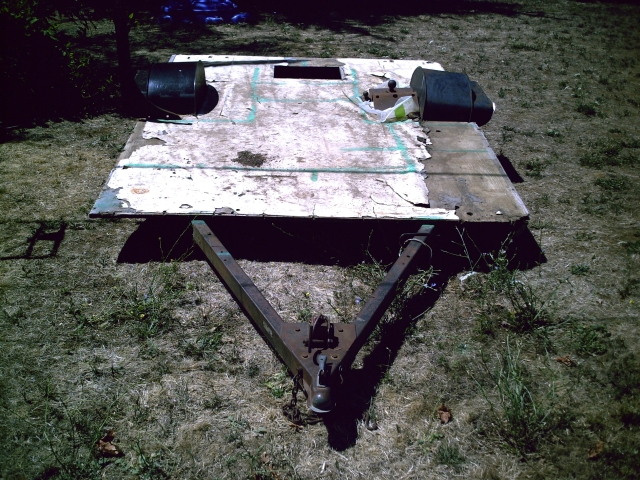

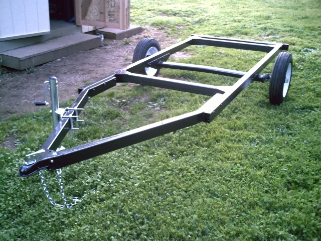

This is my pop up frame...before and after:
"When a hammer is the only tool you own, every problem begins to look like a nail..."
ImageFrom this: Image to this: Image Finally!!
