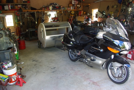

My pico light built to plan size except 1/2" floor and double wall sides and roof I built to tow behind my motorcycle
had it weighed 260# will finish with vinel to cover screen
Jim

it tows very easy behind the bike
jim

Awesome, first one I've seen built. Really like your camper.

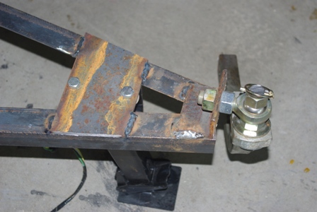

I went buy the plans on this site except I used 1/2" for the floor and I used the same 1/4" for inside the plan calls for 3/8" floor
and single wall side I went the screen for better venting the toung I used 1 1/2 x 1/8" angle with a heim joint as a coulper
the box tubing is strong but what the plan called for was so thin wall I thought it would rust from the inside out to fast
and I used FRP panels to cover the 1/8" ply on the roof also I added 1/8 ply on the bottom to make floor stronger and a smoother
air flow the weight extament on the plans is off I came out with a weight of 260#
Jim

I think that shell would be strong enough for the extra length with out the extra weight of the HF trailer but if you
have a coupon for the HF trailer it would be less $$ than the torsion axels HF trailer with 14 ga aluminum diamond plate used sears car top carrier about $ 225.00 had a coupon cartop used made the hitch swivel been on the interstate 75+ mph you dont know it is there good luck with your build
