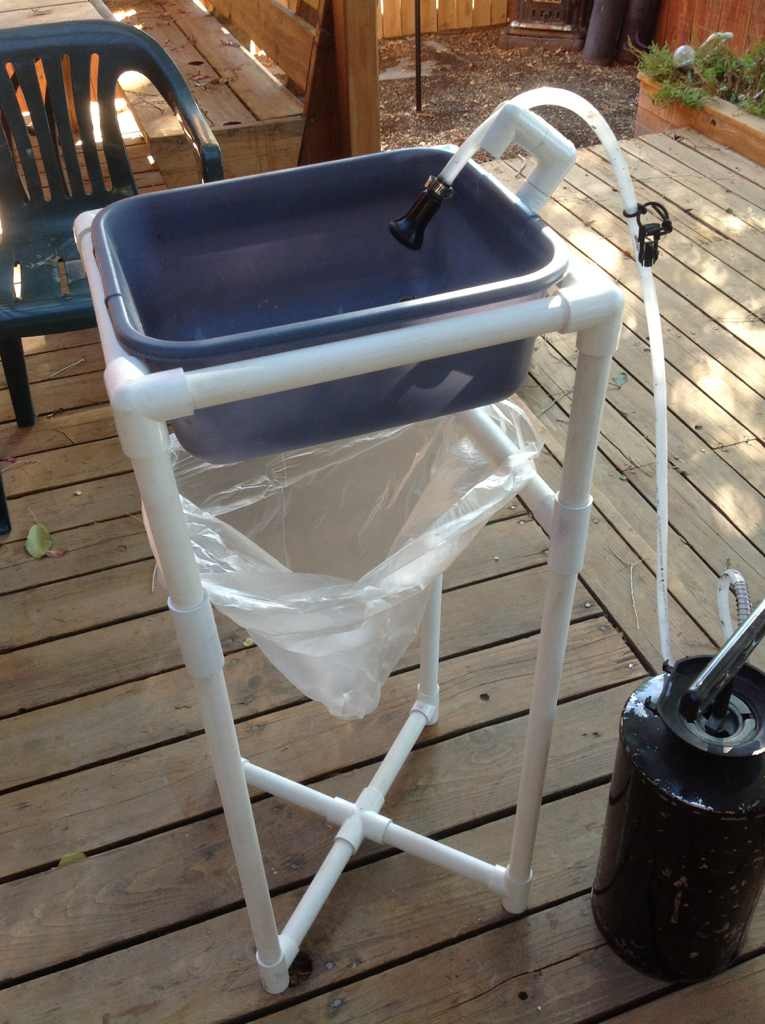

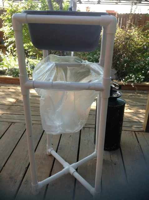

When we first finished our teardrop, i made a pvc trash holder from these instructions. http://www.gspiglet.org/pvcplans1-9.pdf. http://www.gspiglet.org/pvcplans1-9.pdf. works great, but i figured out it held way too big of a bag for a weekend trip, so we got a pop up instead. Our tear does not have a sink, i like having the counter space. However, there are times i would like a sink as well. Si i repurposed my pvc garbage holder into a sink older that also holds a smaller
Garbage bag. By cutting a slot in the fauctey looking pvc elbow on top, it holds my stove top pump up Water heater made from a weed sprayer. I had previously used the sprayer for my shower, not it is dual purpose.
Now i have a simple sink that breaks done into small package.

nevadatear wrote:...it holds my stove top pump up Water heater made from a weed sprayer...
I want to hear more about the DIY water heater.

Metal weed sprayer. Remove the sprayer arm. Attach some tubing to can at the nipple with hose clamp. Attach spray from solar shower (available from rei for a couple of bucks). Fill with water. Place on stove. Makey sure you remove the pumper part that is plastic. Heat up to desired temp. I use an old hot tub thermometer to make sure it is not too hot. Pump up to pressure. And now you have hot water for a shower or washing dishes. Same principle as zodi extreme. Just 1/3 of the cost.

Metal weed sprayer. Remove the sprayer arm. Attach some tubing to can at the nipple with hose clamp. Attach spray from solar shower (available from rei for a couple of bucks). Fill with water. Place on stove. Make sure you remove the pumper part that is plastic. Heat up to desired temp. I use an old hot tub thermometer to make sure it is not too hot. Pump up to pressure. And now you have hot water for a shower or washing dishes. Same principle as zodi extreme. Just 1/3 of the cost. There is an old thread with pictures somewhere on the forum.
