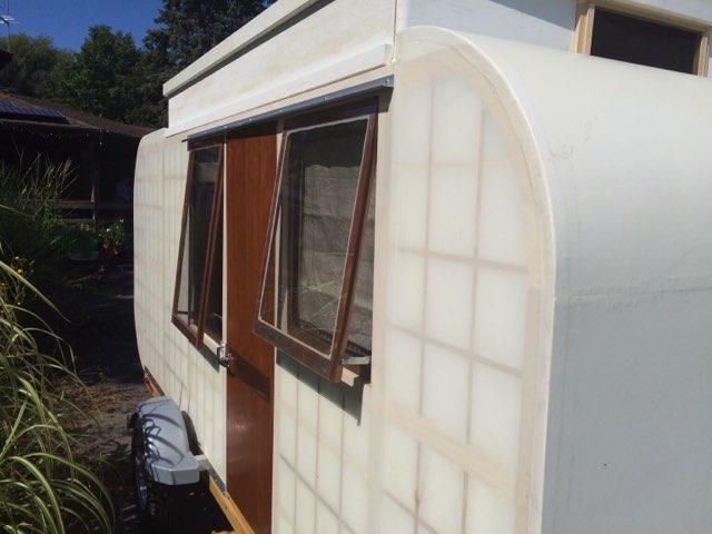

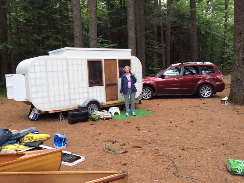

Postby tmoenter » Fri Sep 25, 2015 5:50 pm
My 750 pound Dacron-sided "Sorta-Scotty"
I have been working on my Dacron camper for a year. Nearly complete. Got rave reviews at the TCT NE rally at Sampson State Park.

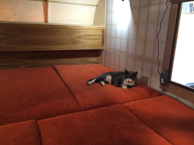

Postby tmoenter » Sat Sep 26, 2015 5:03 pm
Here is an inside shot. Queen sized bed. 6 ft 3 inch standup height with top popped up. Garageable with top down. Pussycat optional.

Dacron is dirt cheap. Lightweight. Strong. Also will follow compound curves well. I seal with water base spar polyurethane which doesn't yellow.
