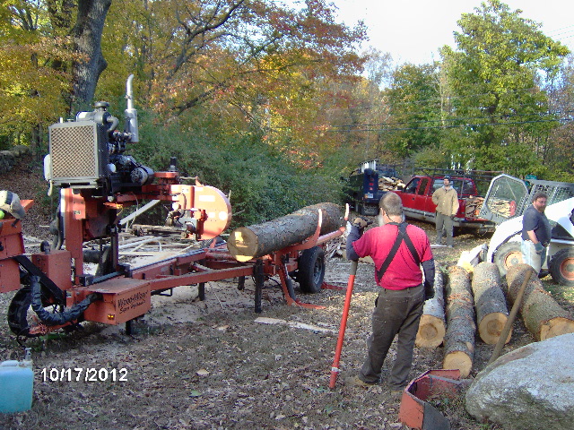

Scott's buddy rolling a log into the hydraulic arms using a log Peavey (that spiked pole thing with a hinged hook used to roll logs).

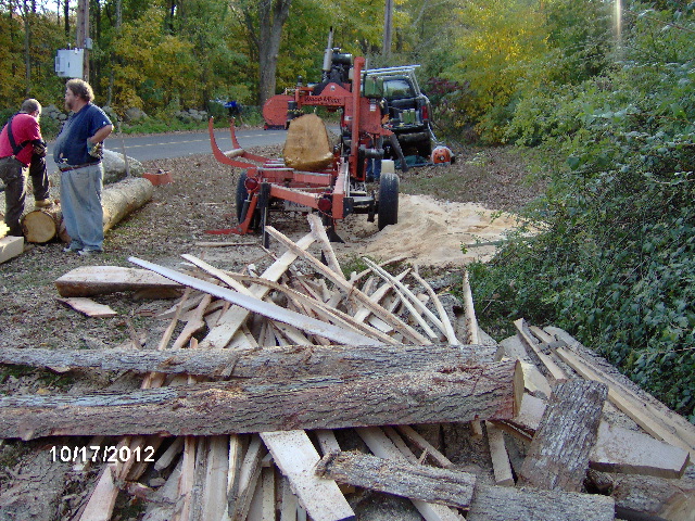

Karl was scrounging fire wood from the waste, standing w/ Scott in the background.

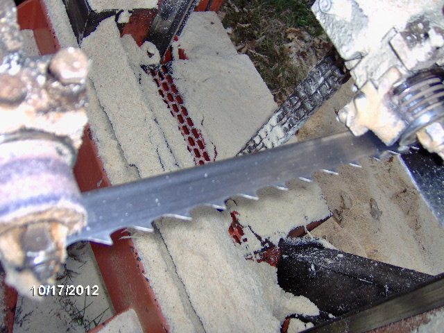

The business end of the tool. I'm guessing 2 tpi. Everything seemed to be adjustable from the operator's position, including the guide roller spread.

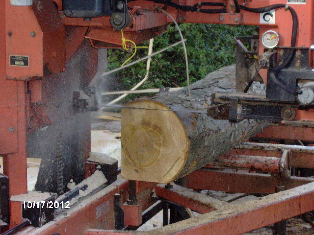

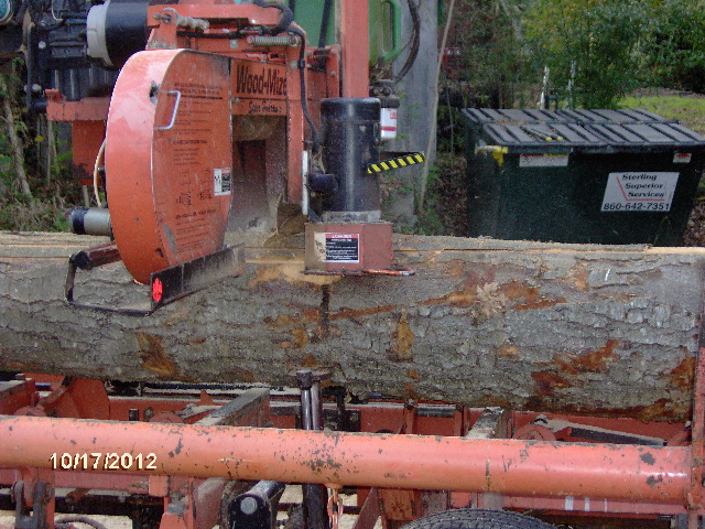

Tried to get a shot of the blade running in to skim off the top side of the log. The 1/2 HP (or so) motor in the foreground runs a rotary saw that chips out the bark ahead of the band saw. Again, operator controlled, only engaged while rough slabbing.

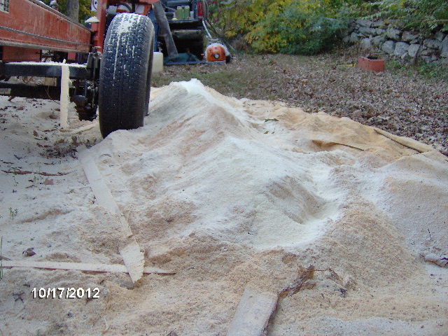

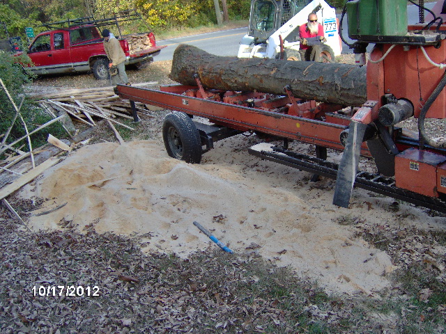

Look at that pile of sawdust coming out of the black hose/chute after a days work! looks like a small beach full of sand!

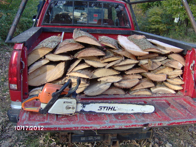

Firewood.

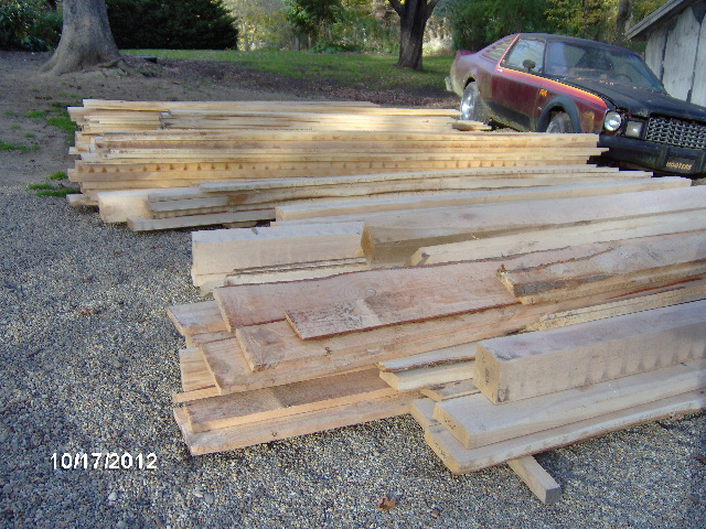

Some of the yield (cherry and maple were spirited away before I arrived).
Scott is also a die hard Dodge and Mazda rotary SCCA race car fan. He has raced grass roots at the infamous Lime Rock, CT circuit.

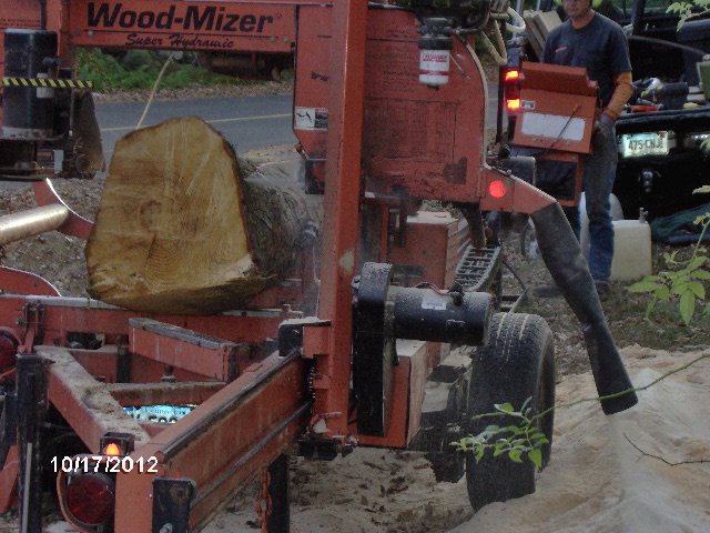

Look at the sawdust coming out of that chute! This thing could rip a 12 foot log quicker than you could count to 10.

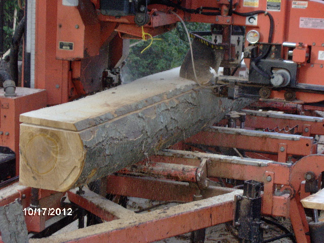

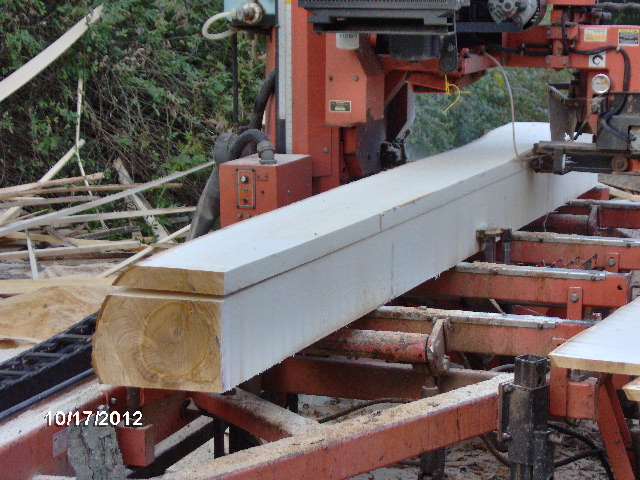

For the second cut he just sort of eyeballs 90 deg, using the hydraulics to flip the log "like budd-er". The third cut.

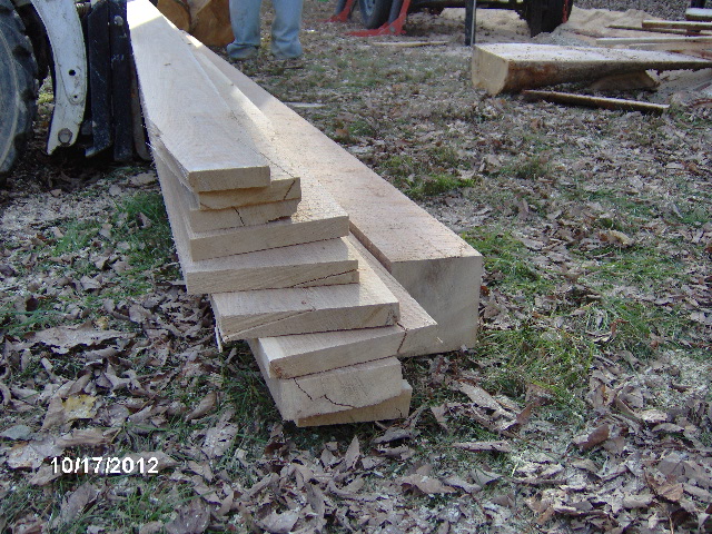

You've heard of planking? This is planking. 5/4 rough cut.
2x rough.

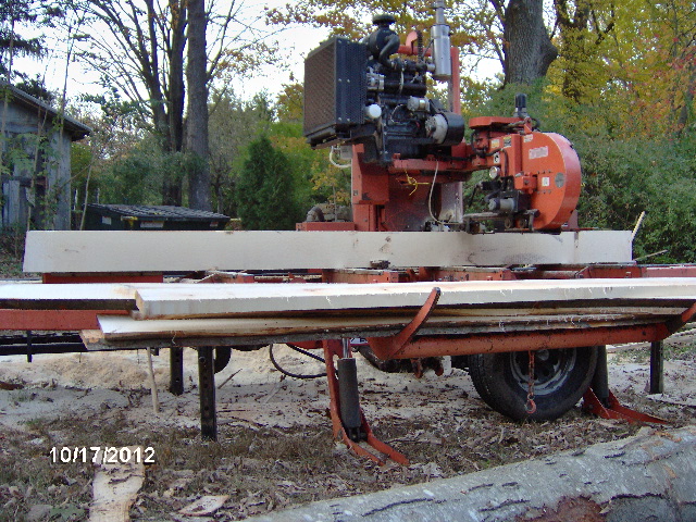

As the boards are ripped the helper flips them back onto the hydraulic arms until they can be flipped back up to trim the edges in one or two operations, depending on the width of the cuts and the edge condition of the log. For the larger posts, he would flip them back to the second side and make a skim cut to true the angle that was eyeballed earlier. The small diesel engine that powers the saw (on top) has what must be the world's smallest turbocharger. The outside of the impeller and compressor housings couldn't have been more than 3 inches diameter. Tiny.
You can see a corner of the garage/shed in the background.

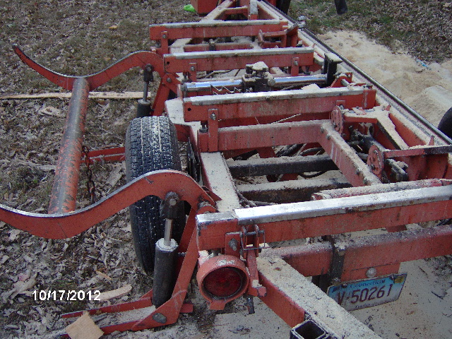

Here is a detail shot of the bed of the saw. In the center you can see the cross ram and telescoping cleat that is used to lift, shove, rotate, position, and dog the logs against the stops on the curb side; as well as a better look at the lifting arms and stabilizer feet on the left.
