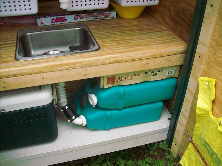

I use a standard 5 gallon water cans (plastic actually) for collecting gray water.
The pouring spout on the one in use is connected to the sink drain trap with a short neoprene hose. When full I swap it out with an empty. They can be dumped at a station or carried home.
