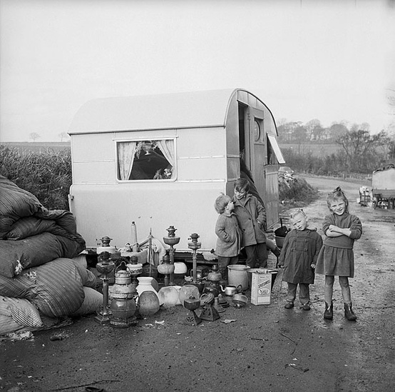

I came across this pic yesterday Image and thought well its a sideways vardo. Seems in England there was a bunch of caravans built shaped like this. Well I came across this on etrailer not too long agohttp://www.etrailer.com/Trailer-Suspension/Timbren/A20RS545.html Timbren Axle-Less Trailer Suspension System with Hubs - 5 on 4-1/2 - Regular Tires - 2,000 lbs which if I installed it in my present vardo I could drop it about 6 inches lower then it is right now.
So I started thinking that if I built a trailer with the Timbren system and was able to get the sidewalls to 54" high (currently thats the inside height of my lil vardo and it is a little taller then the roof of my rav4, but if I were to reduce it 6" it would be shorter then my rav4) and had the roof curve up to say 76" center height would that give me less drag then I have now with the overhung roof that grabs the air as Im driving? Trying for some improved fuel efficiency or at least staying the same with a taller trailer.

Aerodynamics of a Vardo are well, less good than a brick! Anything that rounds corners will be an improvement but unless you come up with something in the way of a truly aerodynamic shape it will be a matter of degree. Google Aerodynamic shapes and look at the images.
I have been thinking of ways to improve the aerodynamics of Compass Rose and the use of temporary shapes is wandering around in the back of my mind. Seeing what is being done in the trucking industry is an inspiration.

I have seen a few of the products they sell like those tabs you can add to the back of a trailer to hopefully improve fuel efficiency...and I agree the traditional shape of a vardo is so un aerodynamic its a joke lol but they didnt worry about it because it wasn't a problem, today we want to be hauling it at 65mph on the highway and fuel prices keep going up and up lol So its why I keep looking at shapes...sigh lol

Consider the old clerestory roof idea with a centre strip that's higher than the rest - I think it was Doug H that said you call them trolley roofs. This can give you the same standing headroom without increasing the height of the trailer over its full width and so not increasing its frontal area and drag as much.
Combined with plenty of front-to-back curvature like in the old Brit 'caravan' below and you can have a trailer that's 4ft high at the ends but 6ft high in the middle. And do you really need the full headroom anywhere except in one spot?
