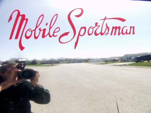

Postby 48Rob » Sat Oct 27, 2012 2:16 pm
Hi Stephanie,
Using tap water can often leave hard to remove spots, sometimes the minerals can etch the aluminum.
Rinsing with distilled water is one cure, though expensive.
Using a spot free rinse system that filters the water, like this one;
http://www.amazon.com/Mr-Clean-AutoDry- ... B0006M56CE
Will reuduce the potential for damage to almost nothing.
After polishing a traier to a mirror shine, it was the only way I could wash the trailer without damage.

Well, Rob's mirror finish is amazing but probably not compatible with my desert lifestyle. I don't need the finish to be perfect, but want to respect the trailer and keep it in good condition. I will look at the suggested website about the brushed aluminum. Since I didn't make the trailer I'm not sure about the specs of the aluminum. I know the builder usually paints his trailers and alerted me of the maintenance if I didn't paint. but I'm still wanting to find a way to keep it "natural". My friend thinks there are pores in the aluminum and the black is the oxidation getting into the pores and it can't get out without a buffer. Thoughts on this?
