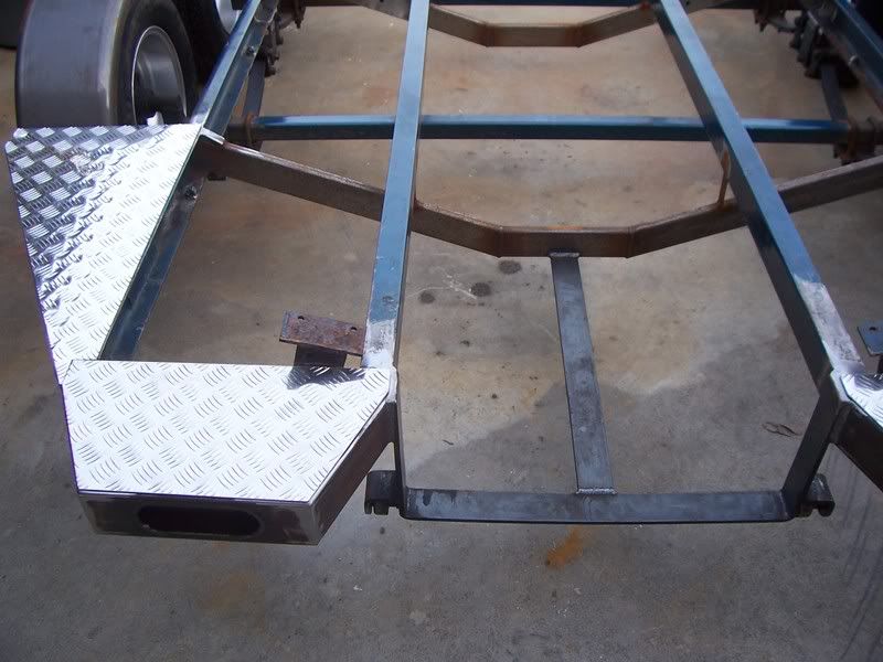

I saw this Aussie TD a couple years ago, or so, when it was
"rescued". I think it was a great design with a funky 1950s profile.
I just now came across this again, and it has been beautifully
restored by its "Vintage Caravan" enthusiast owner. It was
evidently a one-off custom/homebuilt originally. They like to
name their vintage caravans over there, so now this one is
called "Minnie".
http://vintagecaravans.proboards.com/in ... hread=9601
Another approach to TD design to consider. I would think it
wouldn't be too difficult to figure out an enclosure for the
'drop-out-floor if desired.

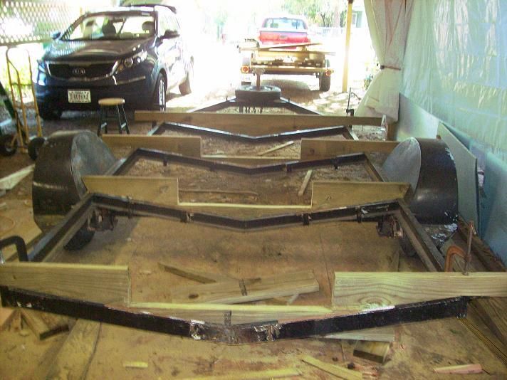

When I was shopping for trailers I cam across a couple of boat trailers that had been specially made or modified for an inboard or v-drive system.
Since I was planning a rear entry I was thinking of a lower drop floor for 3 or 4 feet from the rear to make an easier entry through the door heightwise.
The pop-up trailer I have would also lend it self to a similar mod - the bumper extends about 12 inches to the rear on two arms. I could have cut about 1 foot the center section of the bumper then turn the remainder in to the rear crossmember then cut a similar section from the rear cross member.
Instead I bought a boat trailer where all the crossmembers angled downward to the center and made then entire floor drop.

I've book-marked your build journal so I can follow along on your
progress. I like the wide "V" bottom of boat trailers for just
the purpose you're using it for. That faux metal log siding is
quite novel and should work splendidly for your purpose.
