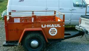

Postby bobhenry » Thu Nov 29, 2012 3:01 pm
Yes it is a uhaul LV 4X6 open top utility trailer. One of the oldies pre 1970. The things were built and rebuilt and rebuilt there were 3 plywood sides that bolted to the ell shaped corners. The tailgate is a lift out and lay aside heavy reinforced plywood section that slides into a u shaped track. The coupler is adjustable from 2 1/4 "+ to 1 1/2" just keep on tightening until it fits. The little horns on the tongue deck was for winding the lighting wiring around during storage between rentals. Yep they were sprung stiff 5 or 6 leafs if I remember correct. You will never overload it but you might get to where you couldn't stop it :oops:
Not the best candidate for a teardrop but if you moved the body 2 foot forward by encroaching on the tongue length somewhat you might make a modified cargo or square butted benroy style by building over the wheels.
This one is a little older but has the same body . However it is equiped with the older bias ply tires commanding the larger fender than the newer ones .
