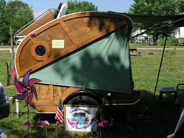

I also saw a tear drop that pivoted, (I can't remember where though) it looked like a PacMan getting ready to chomp a goblin when it was in the raised position. It opened like a clam shell. My kids liked that one.
Guest
Postby mikeschn » Sun Jul 25, 2004 5:42 am
Oh that's Len's teardrop...
