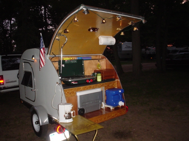

Postby beverlyt » Sun Jul 25, 2004 2:33 pm
Chip,
Ahhh...brings back memories! That glue could make you awful happy if you smelled it too long I think! :shock:
Looks great!
We had a guy stop and ask us all about the roofing material on ours at our campsite this time.
Hey, no flamigos yet, but I did manage to use some patio lights!
http://tnttt.com/album_ ... pic_id=287
Bev
