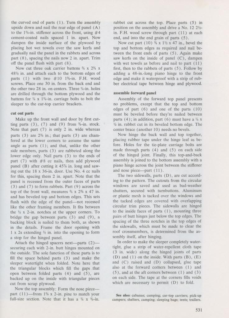

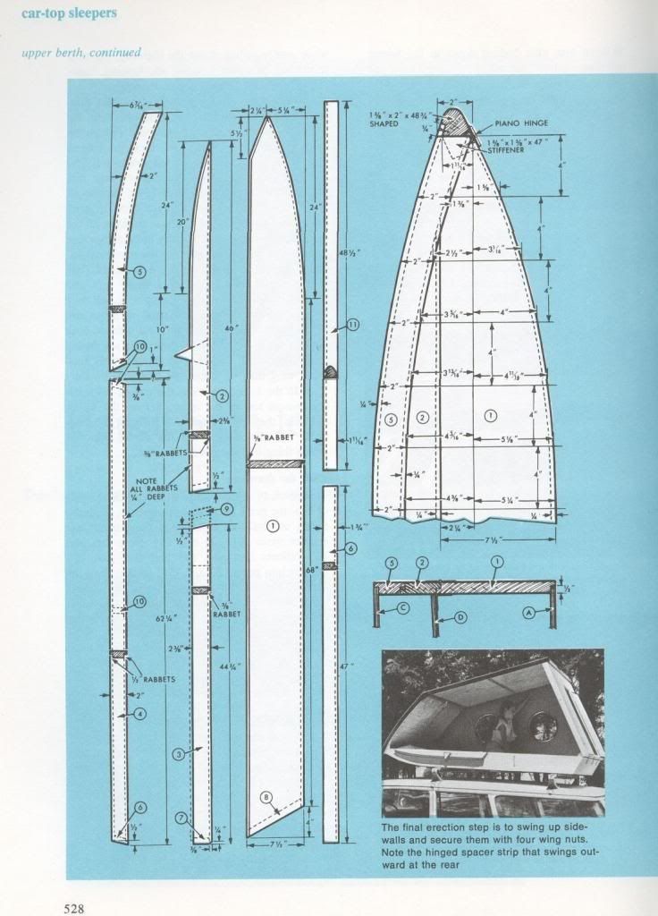

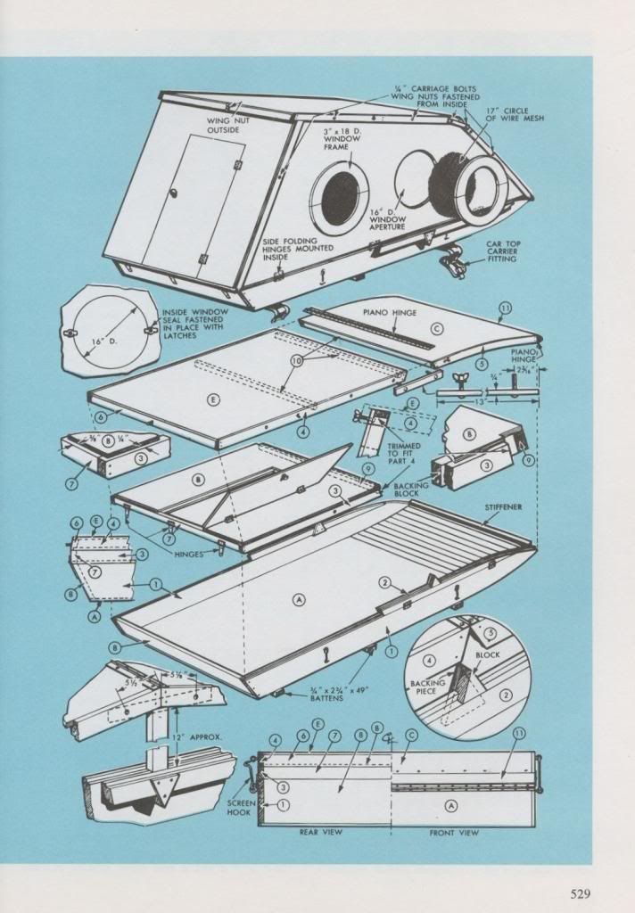

Postby angib » Sat Jan 19, 2013 2:50 pm
Your question made me think of this design - you don't want the folding bit, but the basic construction might suit you:
The plans are full-page scans, so I won't use up bandwidth by displaying them here.
Plans page 1
Plans page 2
Plans page 3
Plans page 4
Plans page 5
Plans page 6
