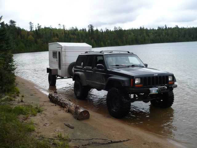

My off road capable trailer is 8' long. As a compromise I made the interior height about 5'3"and the interior width is around 5'3" also. The bed is lengthwise and is over the wheel wells as well. I used a single RV door that I cut down and it is mounted at the front of the trailer on the passenger side. The bed folds in the middle and can be used as a 2 person couch when folded and is 6' long when extended. It is easy for either the wife or I to exit and in the morning I can sit on the edge of the bed, get dressed and step outside. I am 5' 10" so I can,t stand up straight while inside but that is not a problem. When I built the trailer my tow vehicle was a lifted Jeep Cherokee and I wanted something no wider than my vehicle because I travel into remote areas. If I redo the trailer I will keep the same interior height but will make the width a bit larger, it would be nice to be able to sleep across the trailer although it it nice to pull and have it narrow and not need wider mirrors. One definite change would be length, instead of 8' - 10 or 11' would be real nice. If I could figure out some type of simple way of raising the roof when camping that would be incorporated also. I will go to photobucket and post up a picture so you can see what it looks like.
This a shot of the trailer behind my original vehicle. Normally I don,t drive on beaches, however this time I had been checking out a spot behind me and a couple members of our group had stated setting up, blocking me, so i figured a picture was in order.
