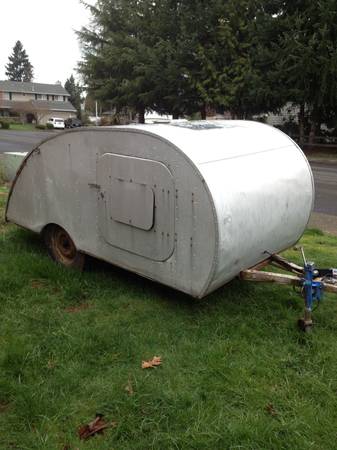

Hello all,
I finally got my Tourette home.
I've been keeping a blog about all the planning I've done and if you would like to see it, you can go here: http://toddsteardropblog.blogspot.com/
As all of you who have tried your hand at restoration know, it's a lot of work!
Today I was able to remove the wooden frames for the windows and the wooden door frames. Except for the floor (which had already been replaced with green lumber) this is the only part of the trailer that is wooden. It was all but destroyed. Luckily I was very careful with it and I will be able to create a pattern for the other side as well.
The aluminum skin is in pretty good shape, no major dents, scratches or holes.
The trailer currently has no 12 v or 120 v system. I have been lurking for a long time and have begun to design a 12 v system for when I am off grid. I don't usually camp at powered sites, but will put in a basic 120 v. system for when I am.
I'm on spring break so I've been able to put some elbow grease into cleaning and planning.
Sincerely,
Todd
