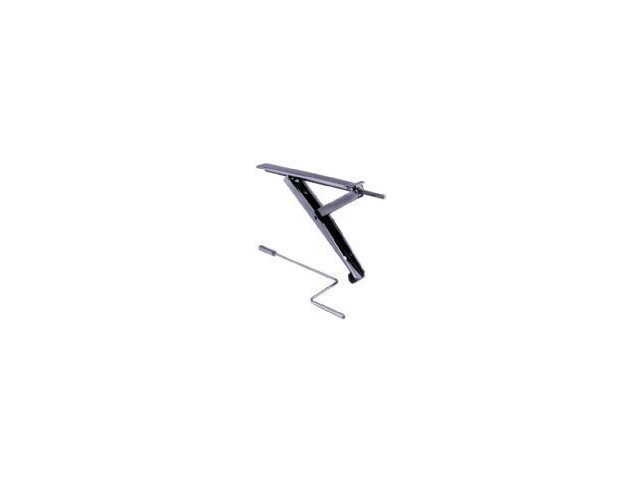

Postby scotty_pac » Tue Apr 09, 2013 11:44 pm
Greg do you mean this kind?

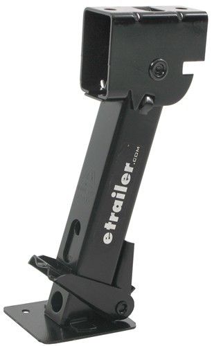

Postby prohandyman » Wed Apr 10, 2013 5:58 am
Yes stab jacks are a must...even with small teardrop campers. Our local pick a part sells screw-up car jacks for $5 each. Would work great, just a little heavy. I have recently switched to these...crank down easily and then crank up almost out of view. The surplus shops have them considerably cheaper than new.

Postby nevadatear » Wed Apr 10, 2013 8:40 am
Scotty, we have just like the photo. They really make a difference, even with the tongue on a jack stand. I can tell when we forget to put them down as soon as i crawl into the cabin. It squeaks more and rocks a little from side to side. Got ours at an rv parts place.
