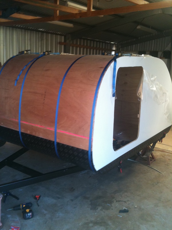

Postby Roo Dog » Tue May 21, 2013 5:01 am
Paul,
We were very professional and used the back patio and some chalk to get the profile we wanted. :D
This was done before we made the chassis.
I do not think there are too many dramas in building a Tear.
Good fun and a modicum of common sense is what they are all about.
Take your time and enjoy the process. :)
Take it easy.
RD
