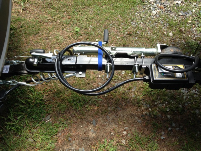

    Because I'm seeing something new to me, I must ask. Is the box with cable the brake controller or some other devise? Are steel cables, instead of chains, acceptable in Canada? The cables seem excessively long & they don't cross under the hitch. Is that kosher in Canada?
    :peace: Fred
alaska teardrop
Posts: 1113
Re: Is there a more "gentle" way to setup electric brakes ct
Postby hwitten » Sun May 26, 2013 8:41 pm
My oops re the cross-over, or rather lack thereof. They normally live crossed. Cables are ok as long as they can carry the weight, etc. and since the trailer is certified I assume the cables are of adequate capacity for my little toy, as my wife calls it :)
The box is the brake controller. The in-cabin handheld piece plugs into cigar lighter for power. It's about the size of a CB mike.
http://www.etrailer.com/Brake-Controlle ... 90250.html
Have shortened up the cable that sits on top of the box in the picture. Was able to just pull it up into the storage area. Looks much better now.
