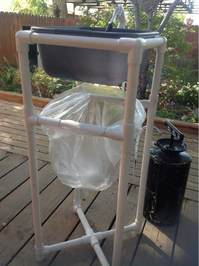

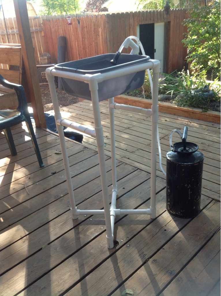

Hey guys, the weed sprayer idea is mine! :;). I have found it also works great for washing dishes. So great we can all share ideas here.
Take of the long sprayer handle and add some tubing from the hardware store, held on with some hose clamps, and get a replacement solar shower nozzle from REI for about 2 bucks and you are good to go. I actually replaced my nozzle recent to a sprayer so it works better for dishes!

Postby nevadatear » Mon Jun 03, 2013 3:55 am
I used a metal can painted black so i can set it directly on the campstove and use sun for solar gain.
