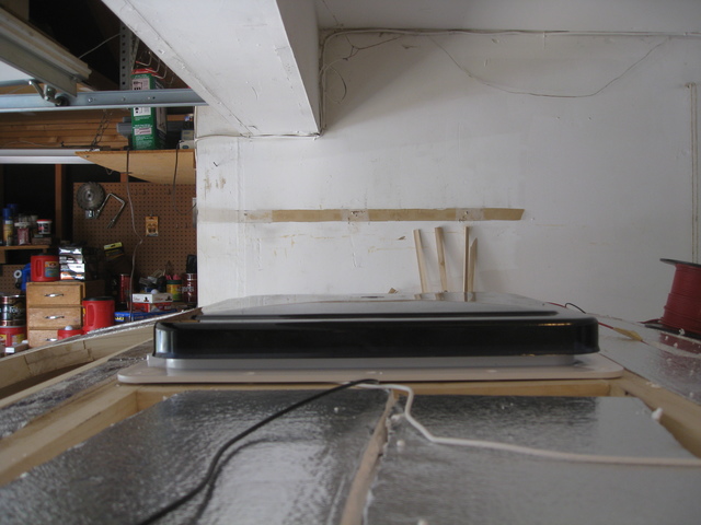

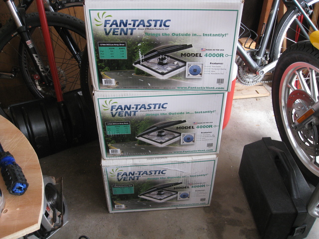

So I have 3 Fantastic fans now...
A few weeks ago I noticed I had a "High Profile" fan after test fitting the one I ordered online on my trailer.
It looked good but it made me wonder what a low profile was and how that would look instead. After doing a bit of research I learned that there are a variety of different types of fantastic fans. There are low/high profile, different lid shapes, colors, etc. Unfortunately in most every case when ordering online, they will ship you whatever they have in stock and it is impossible to find out which specific model you are ordering beforehand. I don't think many people know this on the forum, I didn't.
I ended up calling the manufacturer directly to get the scoop, and talked to one of the best customer reps ever. In fact the whole experience with Atwood was great. :thumbsup:
Jerry the customer rep acknowledged the problem and offered to send a different vent cover for free. Mind you that I didn't order from them directly, but from some other online RV dealer.
Unfortunately the fan motor was not compatible with this other lid. He advised me to check out http://rvvent.com which is the only place I know of that offers custom fantastic vents. I went ahead and ordered a low profile, flat lid, with off white color for the inside trim. 2 weeks later it arrived and It really looks great. You can see the difference below.
So what about the 3rd vent? That was a mistake by the manufacturer and I have to ship it back on their dime. But I still have the other "High Profile" fan, which is what you still have to use the high profile model if your roof is less than 1-5/8" thick. I thought I would share my story and first see if someone on this forum was interested and wanted to purchase it at a discount before I post it on ebay. If you are interested send me a PM.

The low profile vent really looks a lot better than the high profile on your trailer!
Thanks for posting all the info about them. :thumbsup:
