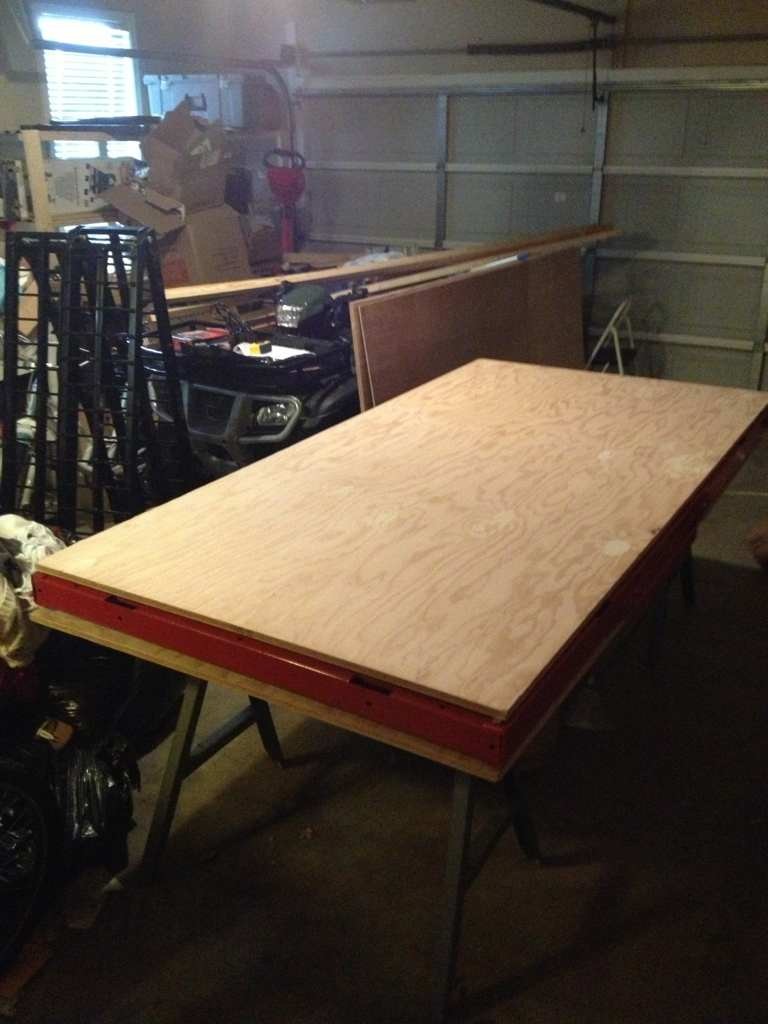

I started building my TD/Benroy this past weekend 06/21/13.
I'm using a HBF heavy duty NON-folding 4x8 trailer and the Ty Dean plans I found from eBay. Plus making alterations when need be after reading this site.

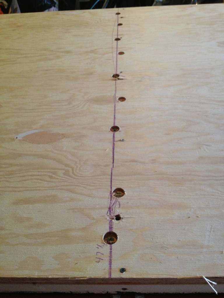

Currently I am trying to figure out how to drill the holes on my flooring to get them to line up with the pre drilled holes on the trailer.
I'm not a handy man at all!
tscarbroughdc
Posts: 120
Joined: Thu Apr 25, 2013 6:37 pm
Re: My TD/Benroy Project
Postby tscarbroughdc » Mon Jun 24, 2013 7:33 pm
You can't tell it but I have the:
HBF Trailer
4x8 sheet marine grade plywood
Framed the bottom of the plywood
Painted asphalt paint on the bottom of the floor/frame
So I've done a little more than the pic shows. NOW I'm trying to figure out how to drill the holes in my flooring so everything lines up!

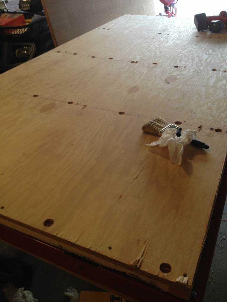

Here is the floor bottom. I just finished the second coat of asphalt paint tonight 06-24-13

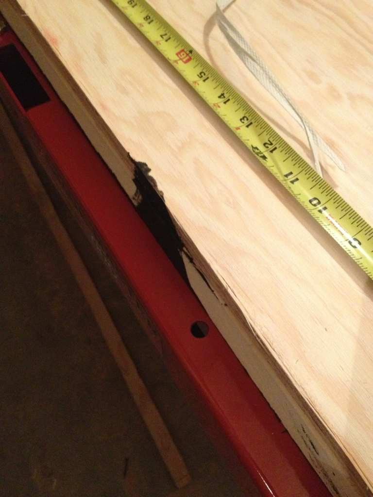

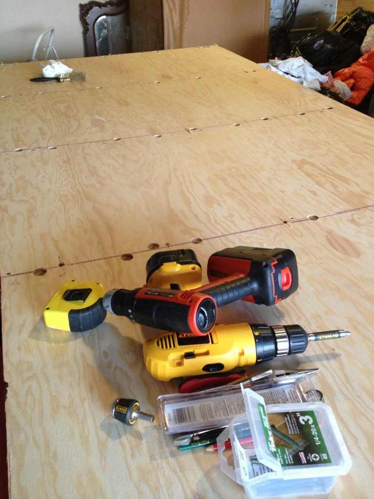

Alright! Today I got the floor attached to the frame!!!! Yay!
I was having a lot of trouble but others on another thread told me to check the trailer frame to make sure it was square and to my surprise it was WAY off! I called a handyman friend of mine and he checked it and we leveled and straightened the HBF trailer and then my plywood floor fit perfectly!!!!
I got tired of trying to align the bolt holes so I ended up using wood to metal screws which made things go A LOT faster. However I now have quite a few holes in my floor that will need patching! Hahaha
Anyways here are a few pics of where I am.
As you can see I have a lot of screws and holes in my floor board now! I'm assuming I can put some flooring over it and cover a lot of those holes.

Oh no. I just realized that I didn't put the flash sealant between the floor and they trailer frame before bolting it down!!!
I hope that's not a big problem!

Sorry I missed your build thread but now I will watch with interest. I drilled little bitty holes put a lamp under the trailer and eyeballed for the marks I made where the holes in the trailer were. jayhawk I don't think he is using a Harbor Freight trailer. I used one and you can see my build in the foamie section. under grits.I had no problems.

Note 2: I would build the frame and attach it to the trailer FIRST, THEN attach the wood to the frame on my next build! I think it would be easier and Id have a WHOLE lot less holes on my floor!!!!
NOTE 3: I LOVE the wood to metal screws!!!! haha...
