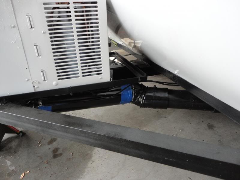

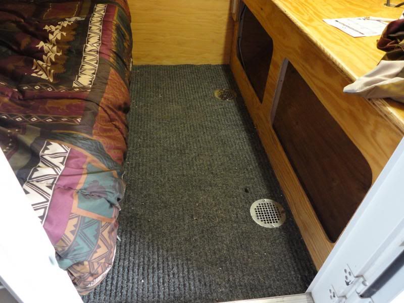

Here is a pic of the way the unit was set up. I purchased the TD about 2 weeks ago:
http://i105.photobucket.com/albums/m232 ... 126ed8.jpg
http://i105.photobucket.com/albums/m232 ... 7c9512.jpg
In/Out house coming from underneath unit....
http://i105.photobucket.com/albums/m232 ... 5def10.jpg
I had taken that part off to get to the old vin for a vin check. New vin sticker was place further up front. , that is why u see the the blue duck tape covering the seems.
Just did that for precautionary measures.. that is the return house...per say
I don't know anything about this subject ............so I need a pro. suggestions? Should I leave the vent open?

My bet is that you are having an air flow problem. Insufficient air flow will lead to the coils freezing. I solved it by using a bilge blower which I control with a pulse width controller.

I agree with SC - airflow is your issue.
Try removing the "grates" and see if this helps. If you see some improvement, you may want to consider either increasing the area of your supply and return lines - maybe have two hoses for each - or increasing pressure and volume using an inline blower.

Looks like you are pushing and pulling air in a 4" tube. There is no flow :shock:
When I made the delivery duct for exterior mounted A/C unit for the barn all I took off of the unit was the cold/cold air.
The return air is fed with the ambient outside air. There is no problem with freeze up and at 103 I have 65 degree air in the barn.

Look at the rectangular duct work the home stores sell. I'd make a duct at least as large as the area of the output vent set. For the return air, I'd make it at least 1.5 times the size of the output duct, with 2X being better. For my home AC, I pipe the output from a window AC unit into the furnace vent system for distribution around the house. I use a 6" round duct between them. It works well in my super insulated home, but have thought I need to go larger with the duct.
When you look at the rectangular duct work, there will be some that are 2"x8" to 4" x 12" or so in size. There will be elbows changing the flow direction. You could run a big flat duct under the unit for return air, then have the cold air go to the interior via a smaller duct run to the side. If needed, it isn't to hard to resize the rectangular duct work, but then you'll need to make your own elbows. Tin snips, a metal edge bender, and pliers are all that is needed.
Looking at your temperatures, it is obvious you are getting cooling, but it look like the airflow isn't enough. One thing that may be happening is the return air is sucking the cold air back and recycling it again.
