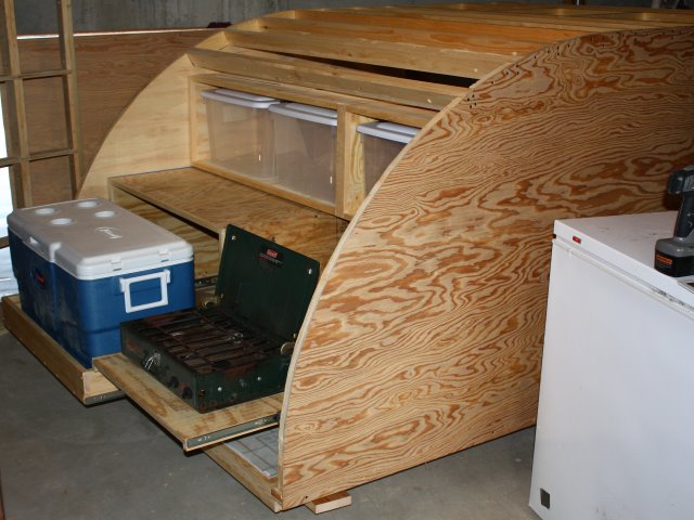

Build your own. Find some plastic tubs in the size you want, plus your cooler, stove, etc...then build your galley/cabs around what you have vs. finding something that will fit what you chose at random. Everything fits that way. Then make your doors to hide your stuff. Don't forget to make use of slides where they will help you.
