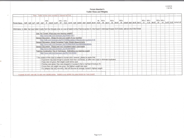

Postby S. Heisley » Wed Jul 31, 2013 5:59 pm

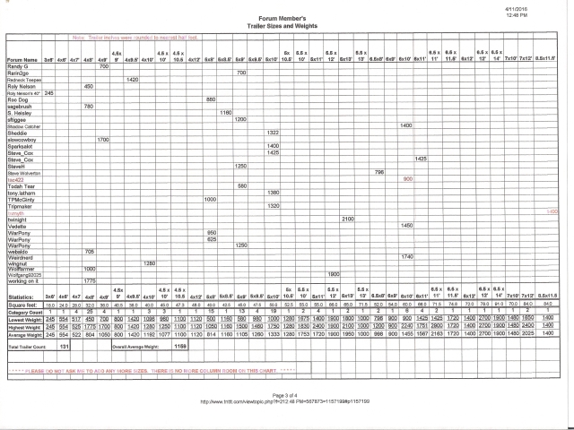

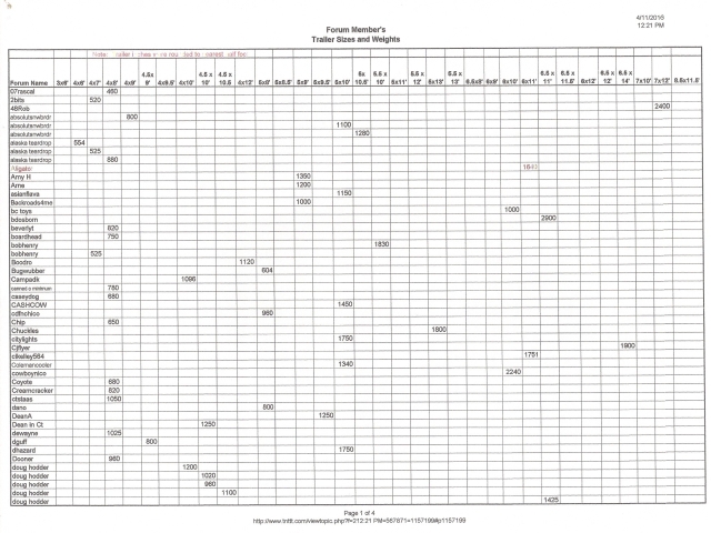

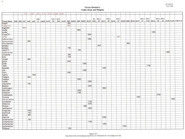

Below is a list of trailers from people who have supplied their trailer(s) size and weight. It is listed alphabetically by forum member ID. Some of you requested changes to your trailer’s weight and others requested that their trailer be included on the chart; so, I have updated accordingly. We now have 131 trailers with size and weight documented. Please do not ask for any other sizes to be entered as we are out of room for any more columns. (Sorry, this is the best that I can do. With the latest column adds, when you try to enlarge the print, the right side cuts off, so, you may have to look at the actual picture using a magnifying glass...not kidding.)
NOTE: Angib's chart is still on page 8, unchanged, and a copy of the original chart that he used is included there as well.
Thanks to all who have contributed!
While the print of these scanned pages is small, it can be enlarged in methods such as follows.
If you are using Google Chrome, you should be able to see three black bars in the upper right corner of your screen.
You can click on those bars and select a zoom strength so that you can magnify the size of the print to get a better look.
(There is a similar feature on Internet Explorer.) Please note that the right side of the sheet may now cut off when you do this. If so, you may need to use a magnifying glass or resort to some other technique to read the print.
The content of this chart is subject to human error; however, please be aware that:
- If someone was kind enough to answer more than one thread, an effort was made to eliminate duplicates
- If size was not given, that weight could not be used.
- If inches were given, they were dropped/rounded to feet or half feet (6 inches=.5')
- If more than one weight was given, the highest weight was used

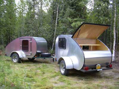

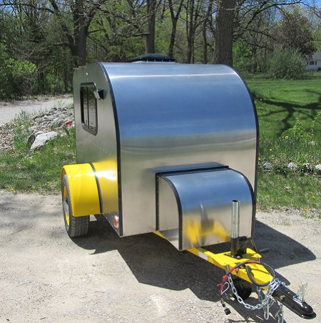

Postby alaska teardrop » Thu Aug 01, 2013 4:43 pm
    Sharon, you've taken on quite a worthwhile & useful project. :thumbsup:
    But hey, what about us folks that build with metal? :thinking:
    Alaska Teardrops - 880# (4x8) Aluminum over steel tube.
    Northern Lite Traveler - 525# (4x7) Aluminum over aluminum tube.
    Stacie's Glampette - 554# (4x6) Aluminum over steel & aluminum tube.
Last edited by alaska teardrop on Mon Aug 05, 2013 3:45 pm, edited 1 time in total.

Postby S. Heisley » Thu Aug 01, 2013 8:35 pm
I thought about that but it's hard to separate those out, as these types have been considered and lumped into "traditional" building styles for quite a while. It would be especially difficult to do that as these statistics started 5 years ago, back in 2008, and some of these builders don't log on very often any more. Most aluminum clad trailers still have traditional framing and plywood or plywood-like interior walls and ceilings. Some have 1/8" plywood under the aluminum; others, do not. In thinking about the aluminum, I had to consider and rationalize that the weight of a 4x8' sheet of aluminum was probably close enough to the weight of 1/8" plywood. :worship: Under the circumstances, I really had little choice.
Also, please recognize that the weight of a trailer is mostly in the hands of the builder, regardless of what materials are used. There will be some who will over-build, totally, with 2x4 lumber and some, who build like you do. Some will build with oak or walnut and others, with poplar. Rookies, in particular, tend to think that they are building a house and put supporting boards or spars every 16 or 18 inches, or even closer, instead of framing sparingly. Each choice makes a difference; but, over-all, the averages that we come up with will give people an idea of what to expect; and, if they want to look at the weight of a specific trailer, the forum member's name will give them enough information to pursue more knowledge. The same may be found true with foamies. Although only a few foamie owners have come forward, so far, one can already see that there can be wide differences in weight, dependent upon the builder's style and even the trailer style. By looking at the entire resulting document, people will be able to conclude accordingly.
For those builders who sell trailers, this may be looked upon as a type of advertisement. People looking for a very light trailer may look at this document and contact you to ask how you were able to build it so light. That just might be your lead into selling them a trailer. ...One never knows.
Thanks for your input. :D
